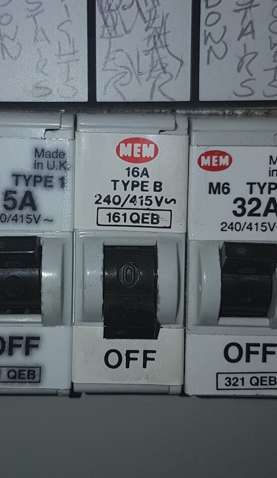

Hi there all. First off would just like to introduce myself real quick. My name is Martin and I live in Airdrie, Scotland!
My Wife and I have lived in our house for a little over 3 years. For the past year or so, I've been experiencing a rather odd issue (which has gotten progressively worse) with a circuit breaker tripping under very specific circumstances. I personally think it may just need replaced but thought best to look for advice first!.
Going into detail, it is isolated to our gaming room (used to be a bedroom). It only trips when I switch my PC on at the wall (flipping the switch on the wall socket). Upon doing so, 9/10 times the breaker will trip. It only does this with my PC, however the power supply in the PC has also been replaced, as has the cord/plug, with the same results.
I have also tried an adjacent socket, and the same thing happens. I have the PC connected via a 4 socket-strip surge protector (which has also been replaced). I find that unplugging the PC from this surge protector, switching on at the wall, and then plugging the PC back into - the now powered - extension works fine.
In summary, I've tried different sockets, switched off all other loads in the room, changed out the surge protector extension - and also tried just plugging the PC straight into the wall, rebuilding my PC and changing it's power supply, and it will still trip when I turn it on directly at the wall with it plugged in, however unplugging, then switching on the wall socket, and then plugging it in doesn't result in it tripping.
Is the breaker just needing replaced due to wear and tear or could it be possible that something else is going on?
I really appreciate any help or advice that can be provided! :)
Thanks in advance...
- Martin
PS. I've attached a picture of the exact breaker which is tripping.

i would first determine whether the circuit is a ring or a radial.if it's a ring, then a 32A breaker might be the solution. also, those breakers are quite old and it may just be "tired" and need replacing. the way forward is to get alocal sparks in to do some investigation and testing.

So a 16Amp CB looks like it would be a Radial circuit rather than a ring, mind you that's an assumption rather than a fact, questio, do you have any thing else plugged in / connected to that particular circuit? could be that the PC is the straw breaking the Camels back with regards to the loading of the circuit, first to is to find what else is on that circuit, NOT what's just plugged into the socket you are using, but sockets in other areas, try switching off that breaker and check what else if anything doesn't work and come back to us with the results.

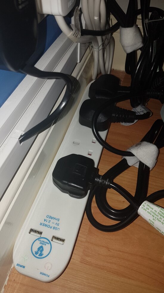

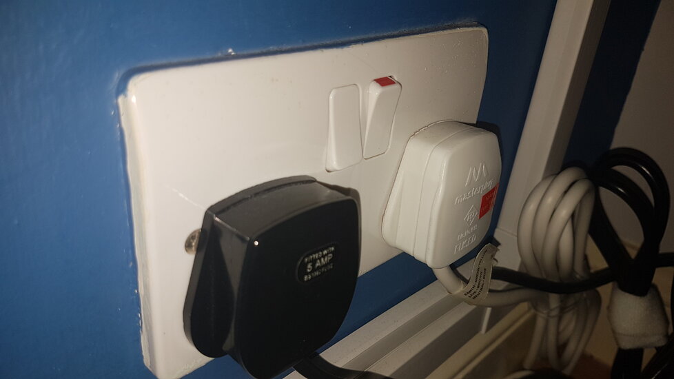

Could we have posted pictures of the offending sockets and the surge suppressed socket strip?

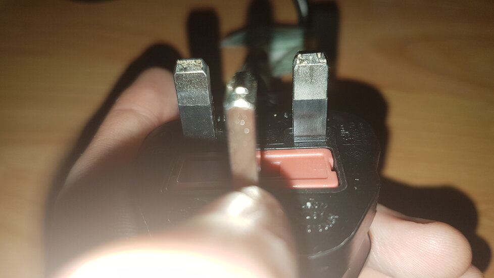

Could you also take some pictures of the PC's plug's live and neutral pins to see if there are signs of pitting due to arcing?

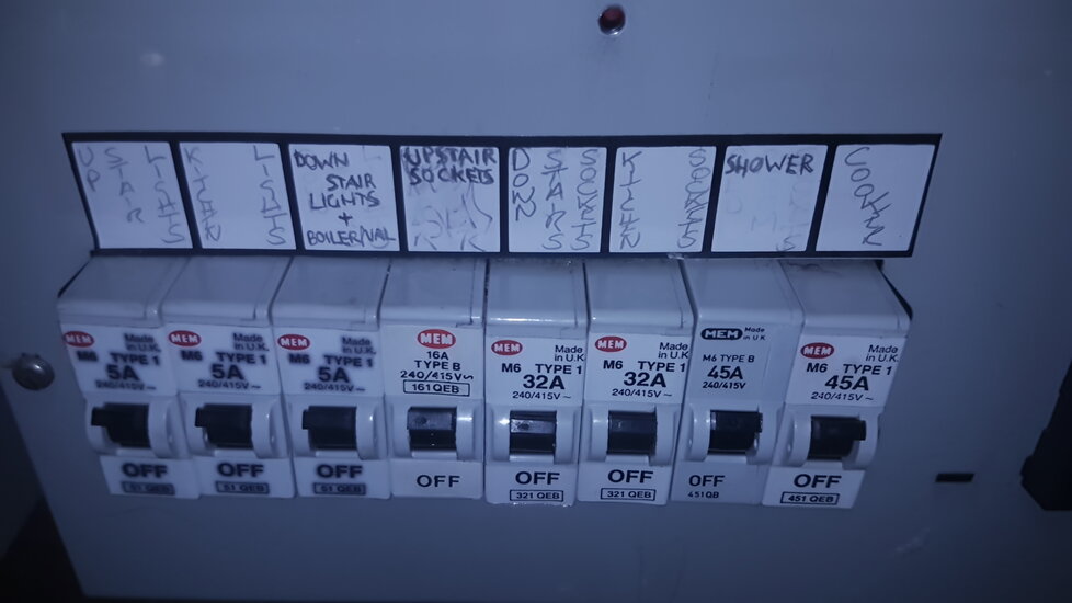

Also, can you move your PC and plug it into a downstairs switched socket on the ring circuit supplied by the 32A MCB to the right of the 16A one? Then do your x 10 switch on test. Take a picture of the socket you use.

I've actually done just as Pete said, and discovered that the previous homeowner has gotten mixed up with writing on which breaker is which. Anyway, I turned off the offending breaker, and it seems it's supplying ALL of the upstairs sockets... not just the ones in the gaming room. Is that right? 16A for upstairs yet 32A for downstairs?

UPDATE: Ok, I've taken some pictures and attached them. I am surprised to see that yes indeed there is pitting on the L and N pins.

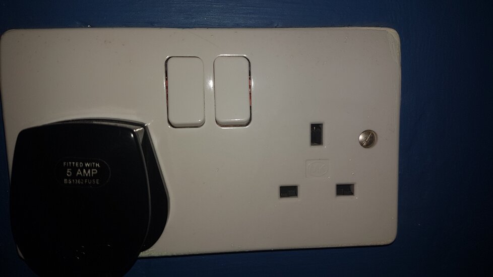

What switching are the sockets ? are they single or double pole
If there is a staggered opening of the switch contacts (live and neutral of the socket)and they do not break at the same time,its possible the Rcd sees this as a imbalance with the type of load being switched

The arc damage you see on the plug pins will only get worse, especially if used to make/break a large inductive load. The plug should be replaced, and any sockets it has been used in should be checked for similar damage.
