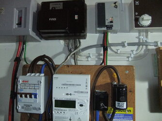

It is a 5-port SMETS2 smart meter and I do not have access to the timer as the off-peak circuit is controlled by an ALCS inside the meter itself. (It's an old setup, with old storage heaters).

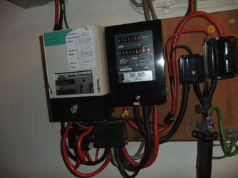

On 04.12.23 my Radio Teleswitch meter was replaced with a KAIFA Smartmeter. This was a requirement of my fixed rate energy deal, and because I have read that my old meter would no longer function when the BBC switch off the long wave signal on 31.03.24.
I have four storage heaters and a single element immersion heater that work on an economy 7 circuit. The Radio Teleswitch meter worked perfectly and my Ecomony 7 use averaged at around 84% per year. Five days after the Smart meter was installed my Ecomony 7 use had dropped to 71% (I had recorded daily readings the week before the old meter was replaced and my Ecomony 7 use was 90%, due to the storage heaters use in the winter).

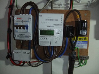

I watched the times that my heaters switched on and off, and recorded the times that the T1 and T2 rates changed over. There is a 30 minute lack of synchronicity between the times. My storage heaters and immersion heater work from 00.02 to 07.02 Hrs, and my Peak Rate (T1) changes to Economy 7 rate (T2) at 00.32Hrs and the Economy 7 rate ends and changes back to Peak rate at 07.32 Hrs. This means the storage heaters and water heat from cold for 30 minutes before the Economy 7 rate starts, and explains the drop in Economy 7 use.
I have complained to my energy supplier and at first they told me I needed to employ an Electrician to change the timer for the Economy 7 devices to my observed tariff times. I have no idea where this timer is, I assumed it would be part of the Smart meter. However they insisted that my tariff times were 00.00-07.00Hrs. When I sent my evidence of the tariff times to them the metering team said my meters timings did not match with the times that they had listed on their system for me. They also compared it with the data on the National Database for my meter and it does not display the correct timings for my meter.
The metering team have advised that currently their Smart meters do not support the timings that I am requesting from them to be switched to and that this is something they are currently working on. Again they suggested that I try to amend the timing on my storage heaters so they are in line with the Smart meter times.

Part III:). I think I have clarity-having spoken to my electrician who installed my heaters, he said that the part of my fuseboard that is...
