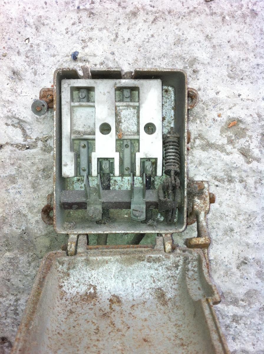

Hello,
I wonder if anybody can identify the item in the attached photographs?
We moved into a victorian property (circa 1900) last year and currently renovating.
We pulled up floorbaords in the hall the other day and found the item in the attached photographs. It's made of iron and has the following imprinted on the front: "15A 250V Made in England". It has two cloth covered wires feeding in from the bottom and two more feeding out the top.
Can anybody tell us more about this item? How old is it? What exactly is it? Where can we find more information about it? I've tried googling but haven't found anything as yet.
Laying close to it was a lead covered section of cable roughly 1/2 inch in diameter which splits into two at one end? Is this related to the other item?
Any help in identifying this item will be greatly appreciated.

They were as common as chips a few years ago
They didn't much distinguish between domestic and industrial at one time
The item was generally made by "Bill" and can be found in many older industrial units in large quantities even today
didn`t prento make em n all......anyway...at one time houses were wired with radials so what you had was a radial feeding 1 or more points in a room. Each radial was fed from one of these fuse iso`s which is why in time you`d end up with a board full of these things as more circuits were added as demand increased.......i think its before the days of ring finals.....both lead and VIR being used as well
yes looks like and old mem switch fuse to me as others have said also made by other companies as well.I have an old book with these things in and it also lists all the kit needed to rewire a house,although it does state that the work should be done by an electrician and that the info is to help you get the right job done.think its from around the 1950,s.

the lead cable.....well, is coated in lead!!....bitumen insulation with cable cores wrapped in paper thats been soaked in a chemical that gives it dielectric strength.....now if you look in the fuse carrier/s on that cast iron fuse iso....you may find theres a strip of asbestos cloth in there to contain any splash from a rupturing fusewire....
