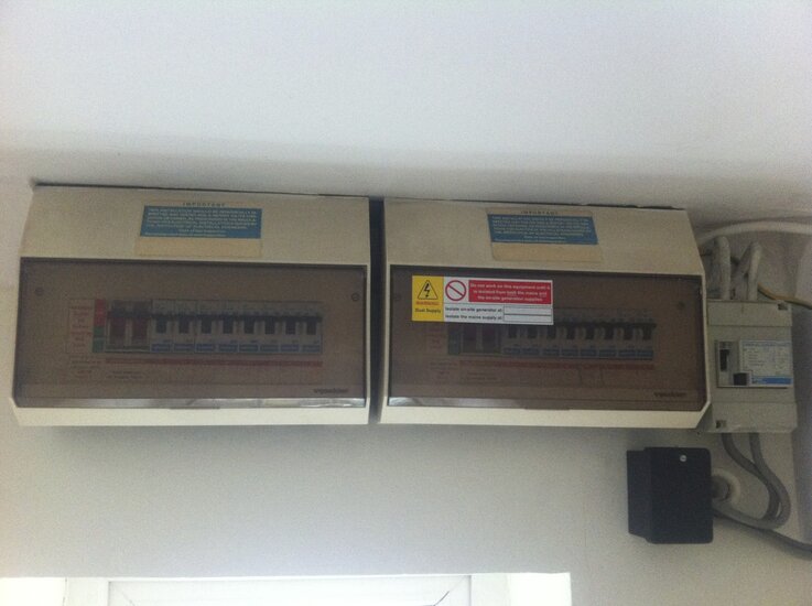

here is a picture of the setup. I tested the lighting circuit allegedly causing the tripping problem (when isolated the RCD holds in) and All IR tests were greater than 299MOhms.
I then tried to ramp test the RCD but it tripped too quickly. I tried a standard auto test but again it tripped before x1.
I have suggested that we lose the upfront RCD and replace the main switch in each board.
Does anyone agree that this would provide a solution? Is the work notifiable? And what RCD main switch can I get for these boards?
Thanks again.
replaced RCD today, with new enclosure. Same thing happens. So I start with everything off then switch on 1 at a time and retest. Eventually it trips on auto test with 1 and a half boards switched on.
Both boards will give a result individually, but anything more than a few circuits on the other one just won't hold an extra 15mA test current. The RCD is holding in with both boards on, so will wait and see if i get a call, when I will change the main switches for RCD's and ditch the up front.
What are the boards supplying? If there's lots of switch mode power supplies (like in computers) or other mains filters connected to the circuits then the cumulative leakage current will trip the RCD. Splitting the whole smash into smaller RCD zones, i.e. with RCBOs might be the only way to overcome the leakage problem.
