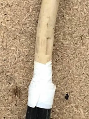

Glanding the cable to a metal fused-switch like the Wylex ones would have been far better, then double insulated tails to the meter.
It looks like the "filler" insulation around the 3 cores has been clamped or similar - wonder how that dent happened?
It looks like the "filler" insulation around the 3 cores has been clamped or similar - wonder how that dent happened?View attachment 112405
Didn’t even see that dent/damage.
Looking at the size of the damage, it could have possibly been some sought of over tightened Earth strap? (But why)? I’ve run out of idea.

Electrical Assessor
Can anyone tell me what is wrong/incorrect.
