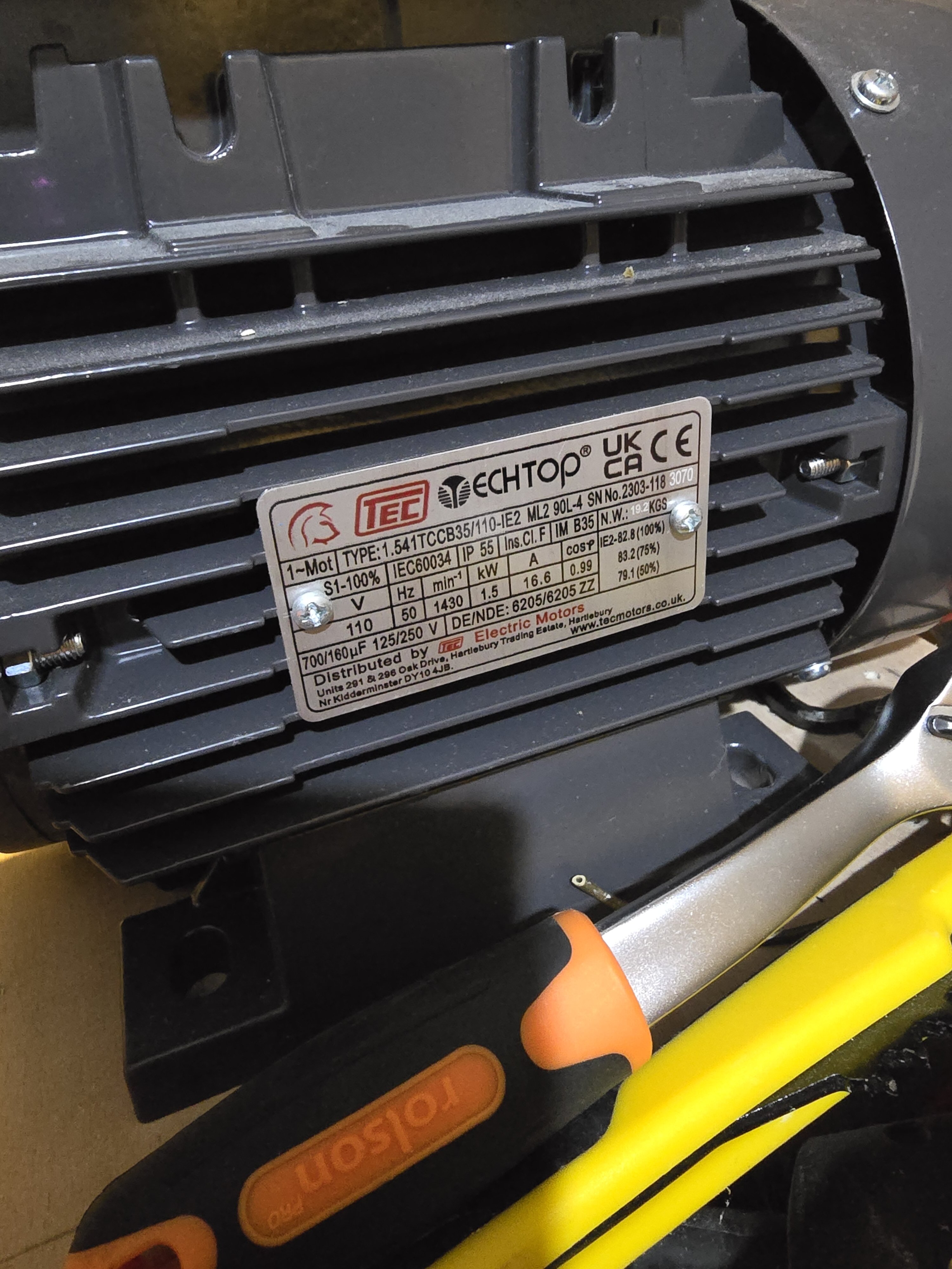

Can someone help me with this motor?
Hi, I'm currently bought all the parts to make a diy 3d print shredder following advice from various resources.
I purchased everything I believe is required.
The one problem I'm struggling with though is woring the motor up.
I'm currently using a TEC 1.5kw single phase motor which has the capacitors already wired in by manufacturer. I would like to use this with a stop start push button which I have at my disposal.
If someone could kindly help my dream come true of shredding 3d waste by helping me with the wiring diagram, I'm be forever grateful!

What voltage are you using? The first photo shows an advert for a 240v motor but the plate on the motor shows it's 110v
