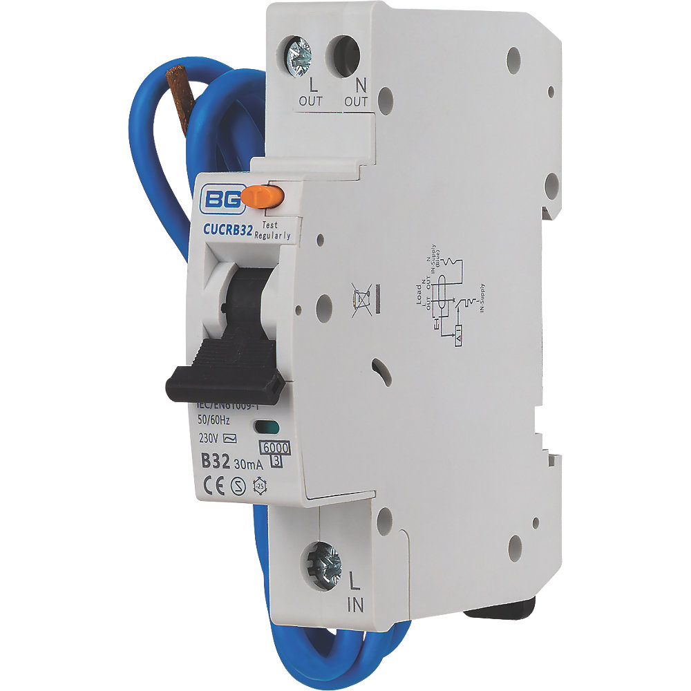

Would one of these be suitable 'BRITISH GENERAL FORTRESS 32A 30MA SP TYPE B MINI-RCBO' on a DIN rail mounted fitting. I don't know what this rail fitting means.

As @westward10 posted it must be the Hager ones. Contrary to common sense and other industry norms, CU do not have standard busbars and so only the manufacturer's compatible ones should be used. This is an issue not just between manufacturers, but also in some cases between generations with the same manufacturer. Looking at you, Wylex!
If you are contemplating changing the 16A MCB for a 20A RCBO you really must verify the cable is suitable, as whoever designed it originally used a 16A MCB for some reason. Quite what it was is not obvious, might have been a previous fixed load like an immersion heater, might have been due to them only having an old roll of 1.5mm in the van. Whatever the reason was is probably ost in the mists of time, so it becomes a job now to determin if the cable is safe for 20A in such a case.
