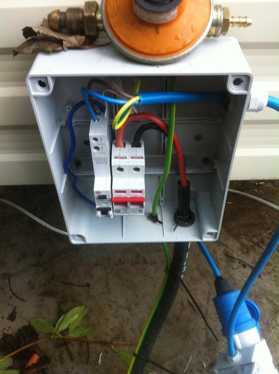

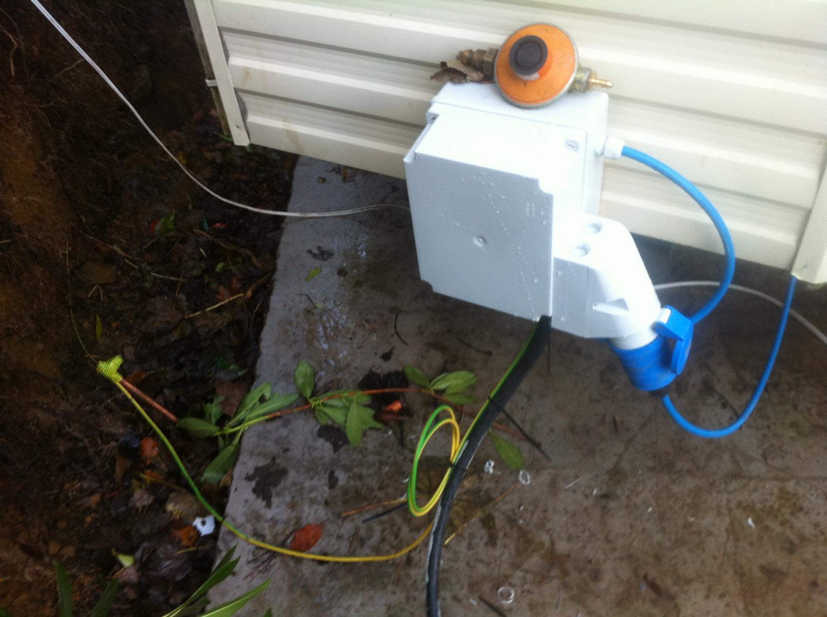

Sorry about asking this question as I think similar posts have been made before but I could not find one along the same lines as this.
A friend of mine has a residential static caravan site (as in the caravans on the site are lived in 24/7 52 weeks a year by the same people).
The configuration of the site wiring is there is a central building incorporating the incoming mains which splits into individual meters for each van, this goes to a 60a sw fuse then into a 60A 30ma RCD then a swa sub main (with the old vans the swa went into the van and connected into a CU incorporating another 60A 30ma rcd and breakers) with the new vans the sparks has installed an external housing adjacent to the van which has a cu with a 60A 30ma rcd and 16A breaker, this then connects to an external 16A socket with a flex into the vans CU - the new vans cu has a 30ma RCD.
He says the vans must have a means of disconnection of the supply adjacent to them as they are mobile homes... some have to be lifted in with a crane so they are not mobile in the true sense of the word.. he also says the vans are limited to what they can use electrically wise as they are mobile homes hence the 16A breaker.
Now the problem is that as the vans are permanent residences they have washers / dryers / toaster / TV's / kettles etc etc which puts more load on them than say a holiday home.
My friend does not understand why we cannot just connect the swa direct into the van as they were before as the swa has an rcd at source which should give the protection necessary, also the small 16A breaker is already causing problems with the resident as it overloads all the time.
Can anyone shed any light on what is the correct connection configuration.
I'd also be binning the two of the three RCDs wired in series to each caravan! The one at the mains intake and the one at the DB adjacent to the caravan! If a TT system then a type-s could be needed at the mains intake position.
Depending on the max demand at each caravan I'd be looking to feed the SWA into a two way IP rated enclosure directly adjacent to the unit with a 100A main switch and a 32/40A type b feeding a 63A commando socket.
so then why the 100A imcomer?
80 A will cut it Damian....it may be cheaper...or the same price for either...
