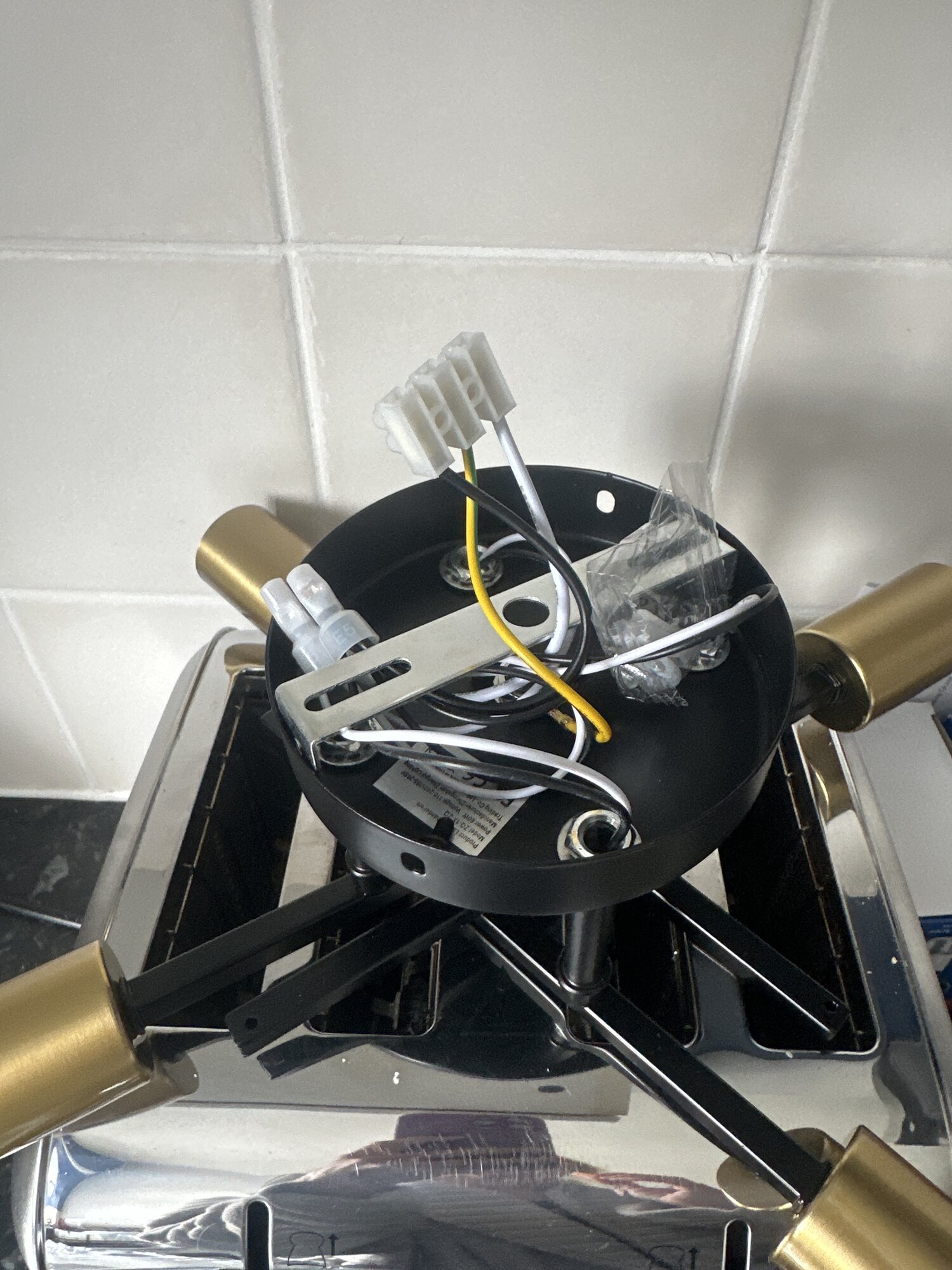

Hi I’m changing over my kitchen light fitting and come across this wiring. My new fitting is a standard 2 wire fitting so not earthed. How would I wire this up into a chocolate block do I just need the live and neutral and tape off the other brown?
Just the one light on ceiling.
Thank you in advance x

Those colours do not comply to UK standards so probably should not be sold in this country. Does it indicate that the white is live?
What voltage is on that label?
looks like "110-240V"

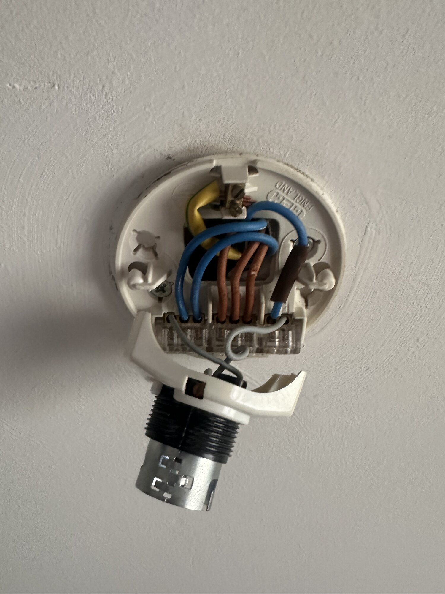

its the standard loop-in or 3-plate wiring method.
Those browns in the middle terminal are live.... permanantly. They need to stay connected together, or all the rest of your downstairs lights will stop working.
The 2 blues together are neutral... same thing, keep these together.....
The single blue with brown sleeve is the switched live.... Do not mix up this blue with the other 2

Brilliant thank you so much for your help 😊 x

As said, looked like there was enough cable slack to correct direct and avoid fitting the wagos in ceiling void

It would normally be the outer terminals where the flex of the pendant drop connect.

Furthermore, as the left hand switch will currently not do anything, I'd try the loose brown in here:
