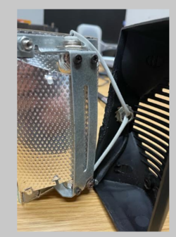

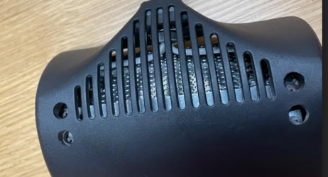

I got dragged into a PAT testing argument....I don't miss this kind of thing!
Cheap and horrible display stand lights. IEC plug. Class 2 symbol. Earthing connected to innards at the lamp end.
On front of unit (not pictured) two knurled bolts hold a piece of glass to the metal innards of the unit, so user can touch the earthed part.
To compound matters the plastic has cracked on all four screws holding the innards to the case.

The argument was mainly about the class II symbol and the earthing arrangements. Comments on that welcome, as the replacements will unfortunately likely be the same units again.
My response was irrespective of that I'd fail it on visual check and structural integrity alone , and for being a cheap piece of rubbish. Someone's repair has provided a further means user can could touch conductive parts of a supposedly class II unit. Signs of corrosion on the earthing link too. Feel I need a shower after touching them...

So is the earth connected to all those accessible screws? Means the double insulated symbol is a load of tosh.
unless. If any connections can come loose, would they touch the metal, or are they within a plastic enclosure, and cord fixed so that can’t pull out?
Exactly my thoughts.
The live conductors are double insulated and soldered to the lamp holder. If that connection failed (ok, more unlikely) it would touch metal.
I just consider these as horribly designed cheap rubbish! The knurled bolts on the front are directly connected to the metal innards. I can't see how by any stretch these are class II.
That certainly is not Class II. No exposed metalwork on a Class II appliance should be connected to earth. Some appliances which are Class II have an earth for functional purposes and is not normally subjected to an earth bond test, these are now referred to as Class II FE and the double square sign contains an earth symbol.
