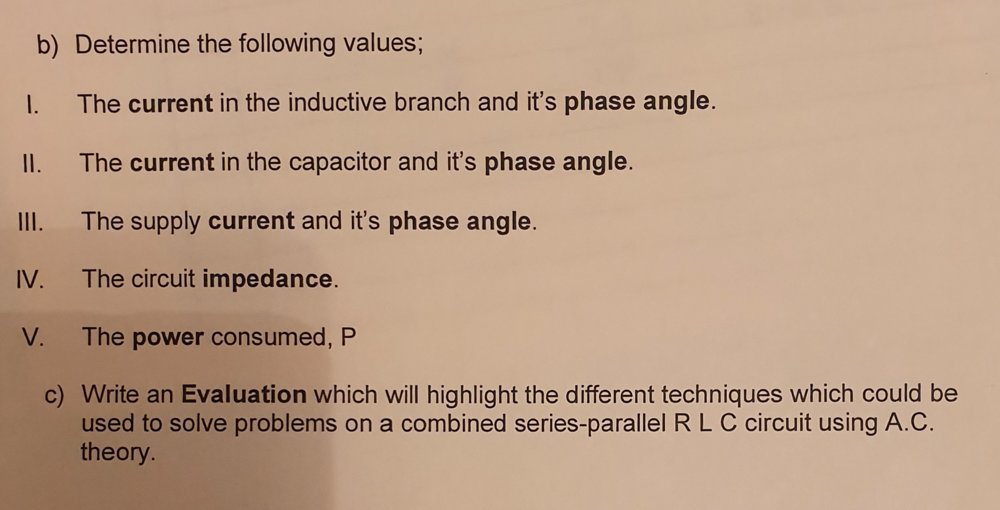

Hi its not just me in my class that is struggling, its pretty much the whole class that is struggling, we have had a "stand in" teacher who isn't really the best of help to be honest. we have raised this as a class to our course leader, but his response was that they are struggling to recruit a good permanent electronics teacher. So for the mean time, we can either make do with what we have or go without a teacher (both are just as bad as each other by the way). So its a lose lose situation. On the brighter side for us, with no disrespect meant for anyone, is that we only have this 1 assignment for electronics and this is the final question on the assignment. I think i have managed the rest of the assignment with a lot of research but these circuits just go right over my head.

Do you know how to work out the total resistance of two resistors in series or in parallel? If you do then you can do the same for impedances - see a little further down this post.
Also do you know:
1. that the current(I) through an inductor lags the voltage (V) across it? So one can say the voltage V = jX x I where j is square root of -1 or a phase shift of 90 degrees and X is the reactance of the inductor at the frequency of the voltage V?
2. For a capacitor, V = -jX x I where this time -j means a phase shift of -90 degrees - the current leads the voltage this time.
3. that the current through a resistor is in-phase with the voltage across it so V = R x I? So no j required.
4. the reactance X of an inductor is 2 x pi x f x L where f is frequency and L is the inductance of the inductor.
5. For a capacitor X = 1/(2pi x f x C) where C is the capacitance of the capacitor.
6. That in alternating current circuits we deal in impedance which is an amalgam of resistance and the two types of reactance viz inductive and capacitive.
7. So a capacitor C in series with a resistor R would have an impedance
Z = R - j/(2pi x f x C).
8. An inductor L in series with a resistor R and capacitor C would have an impedance of
Z = R + j(2pi x F x L) - j/(2pi x f x C)
9. In general, Z = R + j(Xind - Xcap) and if the applied voltage V across an impedance Z is V = Z x I. Z is a complex number. I is the current through the impedance.
10. If one works out the current I by dividing V/Z = a +bj then the amplitude of the current is the modulus of a + bj and the phase of the current with respect to the voltage is the argument of a + bj.
Have a go using these cues to tackle the problem you have been set.

Thank you so much for that information, you have been more help to me than my teacher has been for the past 6 weeks in a single post !!
I'll have a go and post my results on here

The real clue is in the question, it asks for a series of answers, if you answer each one in order, they lead on to the next.
So I just asks for the current in one branch, so from ohms law I = V /Z, you know V, and you know Z as it's R+jX, X being 2 pi f L
This will be a complex number, so you can convert it to polar to get magnitude and phase angle.
Part II asks for the current in the other branch, so repeat the above remembering that capacitors lead and the calculation for Z is slightly different to an inductor.
Part III asks for the total current, so add the two branches, either via cartesian form as you have calculated above, or even in their polar form noting the sign /direction of the complex part.
Part IV is the impedance, so you could calculate it via standard series/parallel method (using the complex values), or as this has lead you down a simpler path Z=V/I - since you have V and the calculation of total current from part III - this would be an easy way to get the complex impedance
And so on...
I don't know how far you are down your course, but in any ac system calculations the use of complex numbers is pretty standard in anything but the simplest problem.
What level of course are you doing?
This is important as the more basic courses won't use complex numbers, and the more advanced would solve using laplace transforms - it depends on where this is going, simple circuit theory (DC, ac and simple DC transient) wouldn't go past the answers above, if you're moving on to control systems or more advanced step functions then laplace is the way to go.
There are many different ways to solve the question posted - it's probably the way we have said, but it does depend on the level and type of course.
Is any of what ive done here correct?
I really dont understand what ive done but i guess ive done something? View attachment 55230

This is what i have managed to do so far but i have a feeling i'm way off what is expected of me.
Can somebody tell me what J is? I know it was mentioned above that its the square root of -1 but when i type this into a calculator it says error
First thing...
You've used a mixture of values for frequency, 240Hz in one case, 50Hz in another. The SPICE parameters shown by the voltage source in the schematic show 50Hz but the question specifically states that the source is a variable frequency supply. I wonder what their intention was; If it is to provide a general solution for any frequency, then an f term will appear in every answer.
