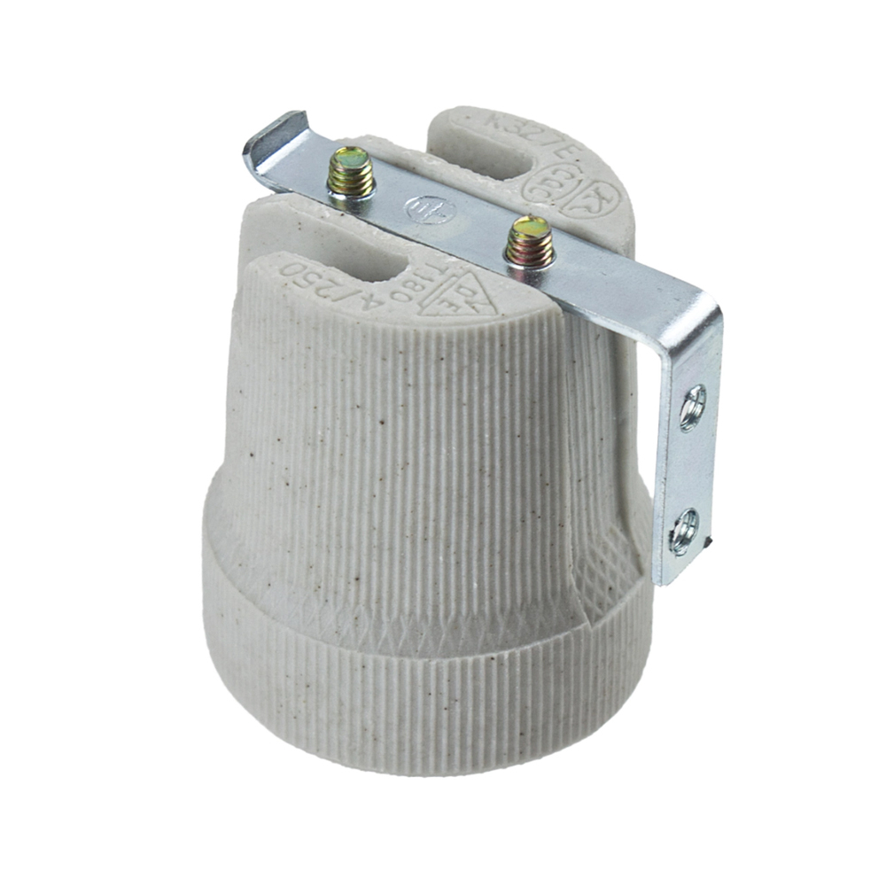

I wonder if that metal tab sticking up from the back of the lampholder is actually an earth terminal. Some plastic holders had an earth terminal fitted.
The metal tab looks to be connected to the case.
That's how they were an L shaped bracket that held the holder and fixed to the lamp base and it had a poor quality earthing point at the top. Like this.
The designers of the fitting cannot guarantee that rcd protection is in place, or if there’s even a cpc present…. So they design their products to class II to cover any eventuality.
It has to have those to be compliant.
