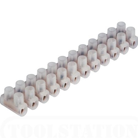

When's the last time you used a standard connector strip?

With the availability of wagos, Line connectors etc.

Only reason I ask is that I used one today in an intermediate switch and got a right -------ing off another guy, saying they are no longer allowed etc.etc. I told him he was talking a load of tripe and to do one. I would have used a wago but I just didn't have any with me.
Also depends how many you need and who's paying ! As for no longer allowed , would be interested in that reg number, what tripe indeed.
As long as connector is correctly rated and accessible cannot see a problem.
used some yesterday on 5 sockets on a ring.
if your not allowed to use connector stip then why are we still allowed to use sockets as they connect to the cable in the same way with a screw?

I use wagos almost exclusively now,mainly because the strip connectors in smaller sizes from CEF are hopeless. the 30's are ok but the smaller ones it's a lottery as to whether the screw has a slot,whether it'll strip...or if you do manage to tighten it the bottom of the terminal tunnel splits.

Had all of the above, now use wago or line
Mostly use Wago now especially if its in an attic.No more fiddling around with terminal screws for me.But I did use connector block recently in a light fitting rose.
perhaps it was in the job specs not to use strip connectors, not necessarily a legal requirement applicable to anywhere else outside of that job
My niceic inspector told me I couldn't use con blocks in the back of a switch unless it was fixed to the back box either by a screw or double sided tape. !!!!!!
