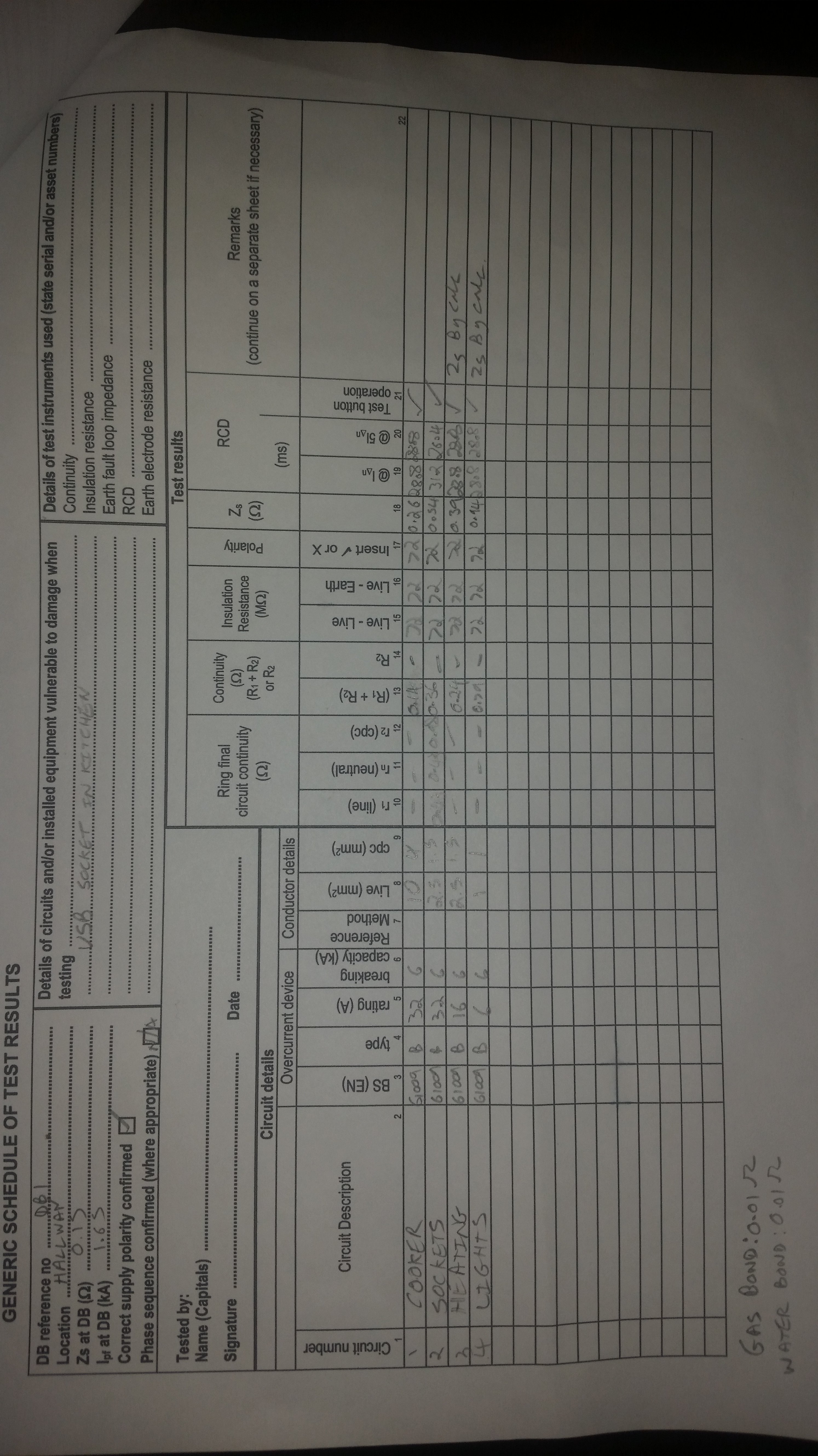

I'm fairly certain it's 1.5mm cpc. I can check tomorrow but pretty sure.
Its going to be quite a timely thing to solve where the roughly 0.2Ohm increase is coming from.
Would you guys invest the time to find the cause or would you say 1 ohm is close enough to calculated value and with all other results being good change board?
In your opinion, based on previous assessments, is this something that could fail an assessment?
What is 0.20 ohms between friends on a conductor that is usually only called upon when something goes wrong. Zs's are good and you have additional RCD protection. Personally I would not worry too much. And yes I would be tempted to record the L and N end to end's as being a little higher and the CPC as a little lower! The assessors are generally pen pushers that like to look at paperwork and not the nitty gritty side of things I have found. That's not having a go at them, it's just the way they are. So, if the paperwork looks about right they are generally happy, and as long as the install is safe. Which I think this one is by the sound of it.

Well done for finding it though mate. I am a little surprised that no one on here asked whether there was a possible long forgotten socket, as it is something a lot of members will have come across, especially on EICRs.

I'd be tempted to record the values as they are seeing as repeating tests and comparing them to recorded values is a usual part of the assessment procedure. I'd rather be explaining an identified anomaly, the action already taken, and the reasons behind not being overly concerned about it, than why values don't match those of the schedule of test results.
I know what you are saying Andy, and yeah OK it's a tiny bit naughty. But cheating L-L up by 0.02 ohms and the CPC down by the same is hardly likely to be picked up on. You will know how values can dance around a bit when testing low impedances.
This install sounds safe to me. It's not like doing a drive by EICR is it.

Totally agree in this specific instance, maybe not in another though.
I know my Elecsa assessor would have picked up on different values as an opportunity for a bonus question such as "Why do you think the values are not as expected ?" or "What could be causing the change in values between measurements ?" But then, most aren't as thorough/bothered as him.
