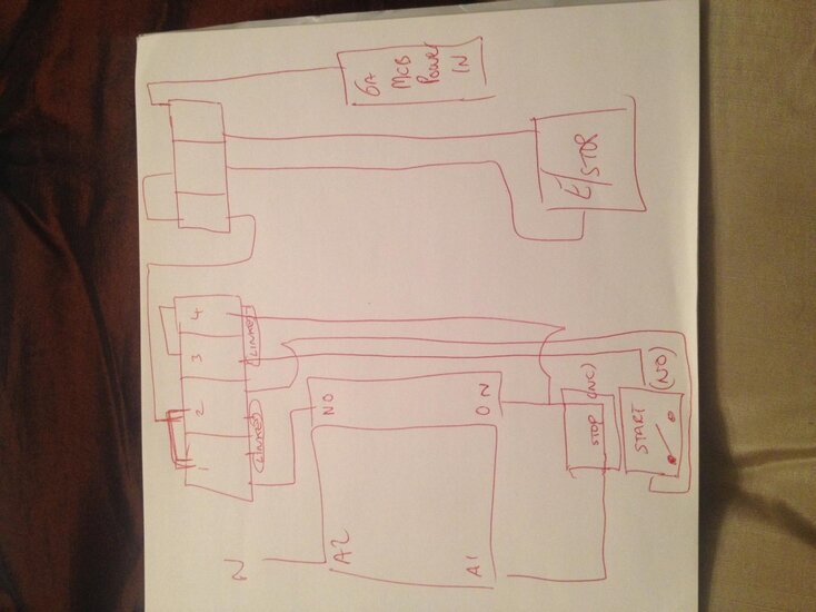

Hello,
I am new to the forum and would be most grateful if anyone here could help me with a project I am working on.
I have a control panel which I have made that controls 2 x heaters and 1 x pump.
Both heaters are 6kW (three phase) and the pump is single phase.
It all works, and I have on/off push buttons to operate the heaters and pump all run via the emergency stop button.
Where I am stuck is that my three phase heaters have a built in thermostat, which switches the contactor from on to off when the heat exceeds x degrees. My problem is that with my current design, unless someone presses the start button again it wont switch back on!
Under my current design, the thermostat isn't installed I left this until last (I underestimated how easy it would be).
Currently, all that happens is the device will turn on and off.
What I want is for the thermostat to cut in and cut off the power to the heater when temperature gets too high.
In my head I am thinking the best idea would be to have a contactor which is controlled via the on/off buttons, and that powers another contactor that is controlled by the thermostat?... or am I missing something that could help me?
I below attach the wiring diagram for both the heater in question and the control circuit diagram.
Any help would be gratefuly rec'd.

Reading the OP hes has wired the stat control to pull in and drop out the contactor, because it dosn't pull the contactor in auto the i assume hes wired the stats in series with the stop circuit hence once stat opens the OP needs to use the start button again.

Just use the stats to switch the contactor coils in and out

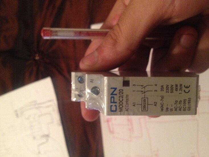

That would be a great help. I have today gone and got another contactor but still problem is once stop circuit is interrupted the thing won't work again. Shall I have a go at doing another drawing for you ?

Have the start stop button pulling in a main contactor then from one of its poles send the supply out to a switch (on/off) which in turn goes to the stat then the switch wire from the stat to the contactor coil for the heater..... this is pretty much what Tony's diagram shows then repeat for 2nd heater.
I assume your problem is your controlling the same contactor with both a start/stop button and stat control and you stat control is acting as a stop command dropping out the retained contactor, this is why you need a independant contactor just for the start/stop command so it remains energised until either Estop or stop is pressed.

Here is my new drawing which hopfully you can see a bit better. This is just one button, the last drawing had all three but they are all identical in how they work.[ElectriciansForums.net] Control Panel for 3ph Heaters

Darkwood, yes this is exactly what I need to do. I have this here which I think will do what you are saying, is this what I need?[ElectriciansForums.net] Control Panel for 3ph Heaters
jparker 86....refer back to post #13 kindly donated by Tony as that is spot on. Only thing i'll add is afew more bits to the key offered:-
K1/1 = N/O contact on pump contactor (K1)
Sw1 = Rotary on/off switch for Heater bank 1 contactor (K2)
Sw2 = Rotary on/off switch for Heater bank 2 contactor (K3)
Th1 = Thermostat on Heater bank 1
Th2 = Thermostat on Heater bank 2
Definitely rotary switches on heater bank circuits instead of push buttons.
It may help if you copy/draw out Tony's donation on paper to help you understand the circuit better.
