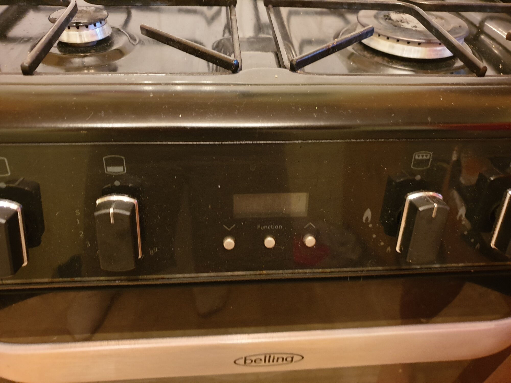

I have a Cooker/crabtree switch but the cooker switch doesn't work? I currently have a gas cooker and it is currently on the "crabtree" switch but I'm looking into getting an electric cooker but I need to resolve this cooker switch problem first. I've replaced the switch with a new one but the problem remains the same, I turn on the "cooker switch" and the light on the switch indicates that it is on but it isn't transferring any power to my gas cooker. I'm not sure what else to do?

If you replaced the whole cooker switch you presumably believe the 45A wiring to the cooker outlet plate below (behind your cooker) is correctly connected. How do you know that it doesn't work? Had you previously tried connecting your gas cooker (currently on the 13A plug), to the cooker switch outlet below?
From those pics you have power to the cooker with the switch off but none when the switch is on?
Can we assume the plugged in appliance is nothing to do with the cooker or is it because the cooker is off when switched off.
Cooker display is on when the socket is on, and off when the socket is off, so the cooker electrics are clearly plugged into the socket.
Cooker switch does nothing except light its indicator.
Yes initially I didn't spot the socket switch being on and off I was looking at the cooker switch.
