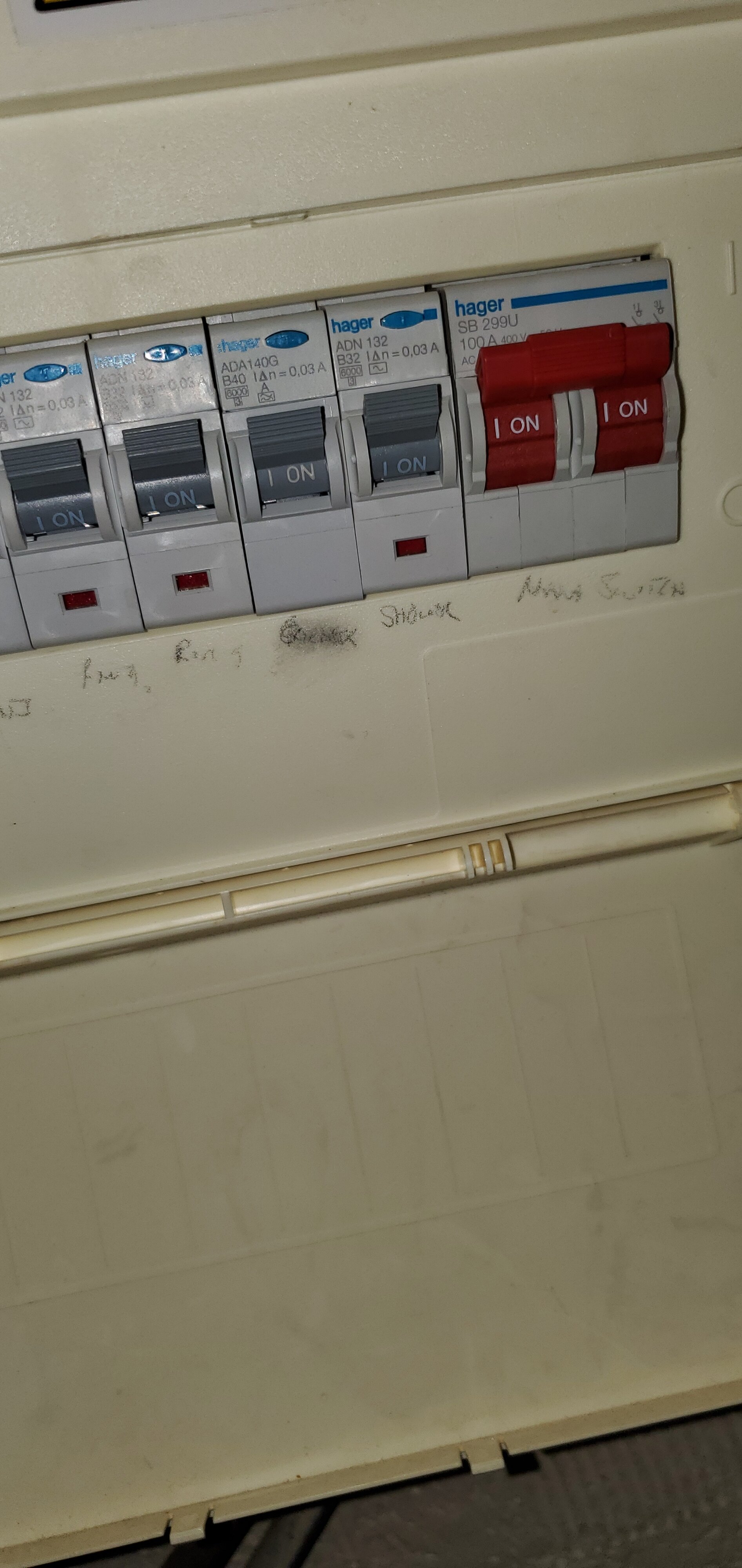

Hi Jock. These are images of the breaker. The cooker is the smudged writing. It seems that it will trip with just 1 hob on for a period. Thanks

Thanks.because it's a combined mcb and rcd [rcbo] it could be tripping due to a neutral fault .if the cookers new then each part of the circuit would need to be tested and tested with cooker cable removed from rcbo ,switch would need to be disconnected as well as cooker outlets.check for plate screws incase it's nipped a neutral or live ,it's easy done.also if it's metal boxes check for grommets in back boxes ,make sure no basic insulation is touching or even close to metal knockouts . At furthest point in circuit check for any voltage on neutral wire this should be close to zero , .it should be easy to identify using a low reading ohm metre [a multi function tester] connect the live and earth together at consumer unit and then test between live and earth at cooker switch ,take note of result.repeat the process with the neutral, the results should be exactly the same say 0.12 ohms.do this with every part of circuit ,switch down to cooker out let [if there is one ] is it a free standing cooker or is there a separate hob and oven on same circuit/switch maybe the oven is the problem ..when your happy with readings then you can do a insulation resistance test on each part of circuit .be carefull that your cables are removed from rcbo ,switch neon if there is one and most important cooker oven . Then test between live to earth ,live to neutral and neutral to earth .you can do this at 250 volts .it could also be an issue with another circuit possibly.make sure your electrician does this as he will have the proper tester and safety equipment

The picture on the left shows a blank missing on the far left.
This is very dangerous.
Do not put your fingers in that hole.
You need to get an electrician to put a blank there immediately.
