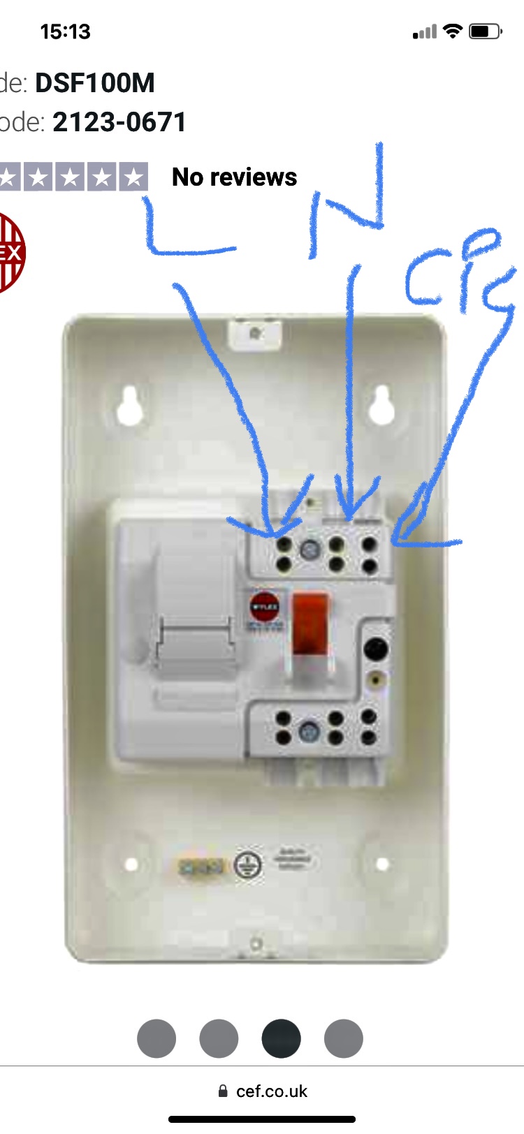

Hello can anyone advise what they would do in this situation please. I have a wylex 100amp switch fuse that has an incoming and out going cpc connection which takes up to a 16 mm cpc. I have 16mm incoming and outgoing cpc, however how do I then earth the enclosure and the banjo as the cpc connection has no connection with the enclosure
Tails in swa out
Could you just take the 16mm CPC to a crimp lug bolted to the SWA's banjo and, assuming 3C SWA, also put a lug on the cable's SWA conductor to the same bolt?
i.e. Ignore the switch's through-CPC connection and the box's terminal strip completely.
EDIT: Also you could use a nylock nut if concerned about it coming loose.

Yes I think that is the only option, it’s a lot of extra faff and the switches are not cheap

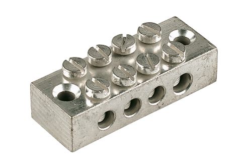

Could you knock the existing small terminal block off the box and fix something like this in its place with a pair of machine screws:
You might need to have nuts on top and use countersunk heads coming through from the back to is fixes flush though.

That’s a good option it’s a shame I have fifteen to do of these
