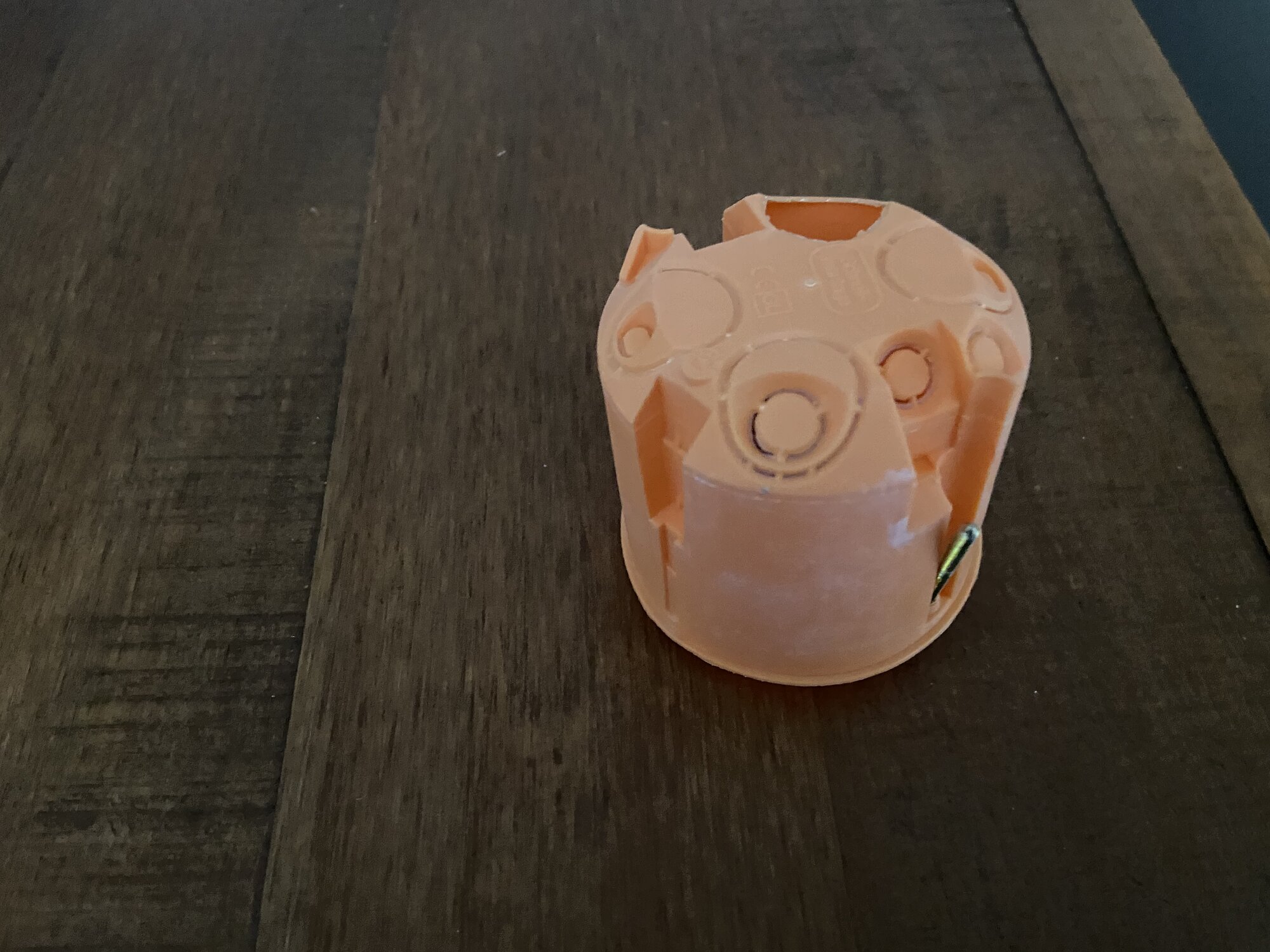

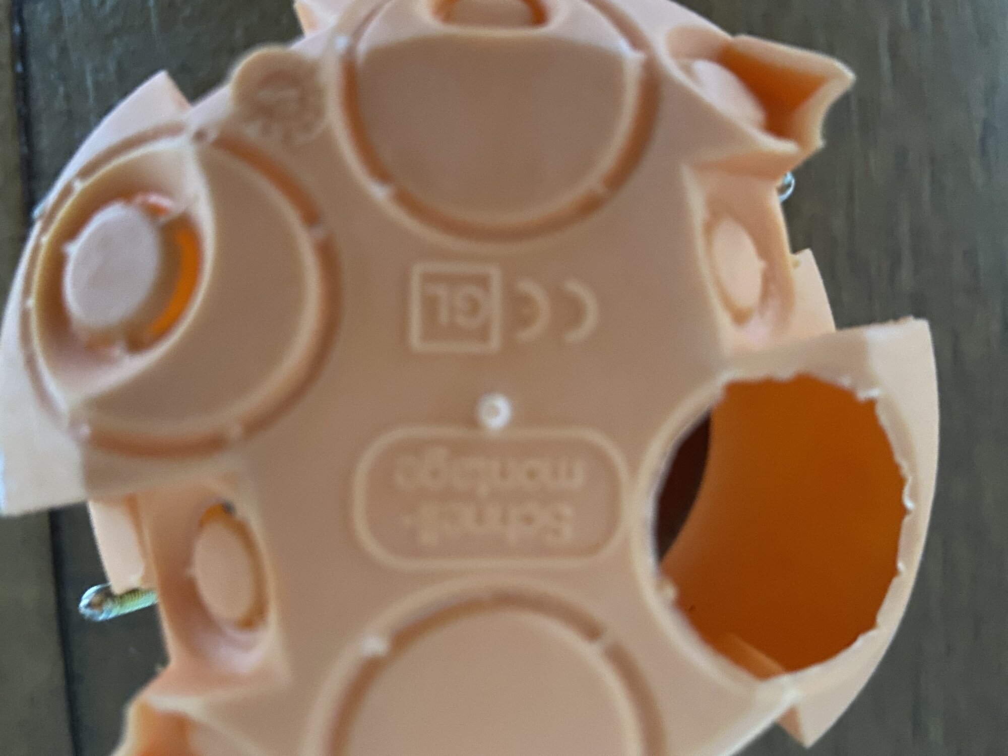

I had issues a few months ago looking for sockets for a German built kit house, but the back box looked like these… but in orange. They did have a fixing tab. (Tightening the small screws brought tabs forward and gripped the dry lining.)

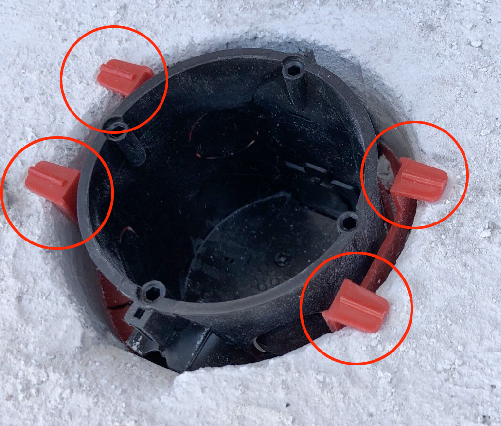

As @kropaske says, they are really intended for walls that are going to be plastered afterwards. But I had a quick search on a couple of German electricians' forums and a few people there say that they use the Klemmfix clamps for unplastered finishes too, by cutting off the 4 little "grabber" hooks once the box is in:

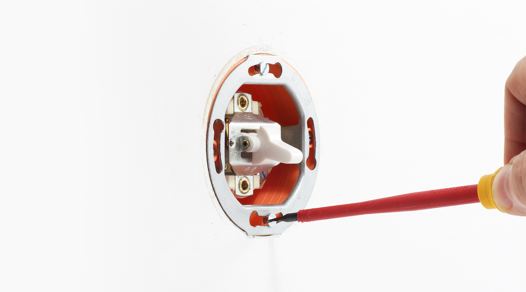

As for your comment about the boxes being perfectly level, the advantage of round boxes is of course that you can rotate them a bit (until the bonding has set). Also, the switch/socket inserts can still be rotated as well before tightening the screws:
