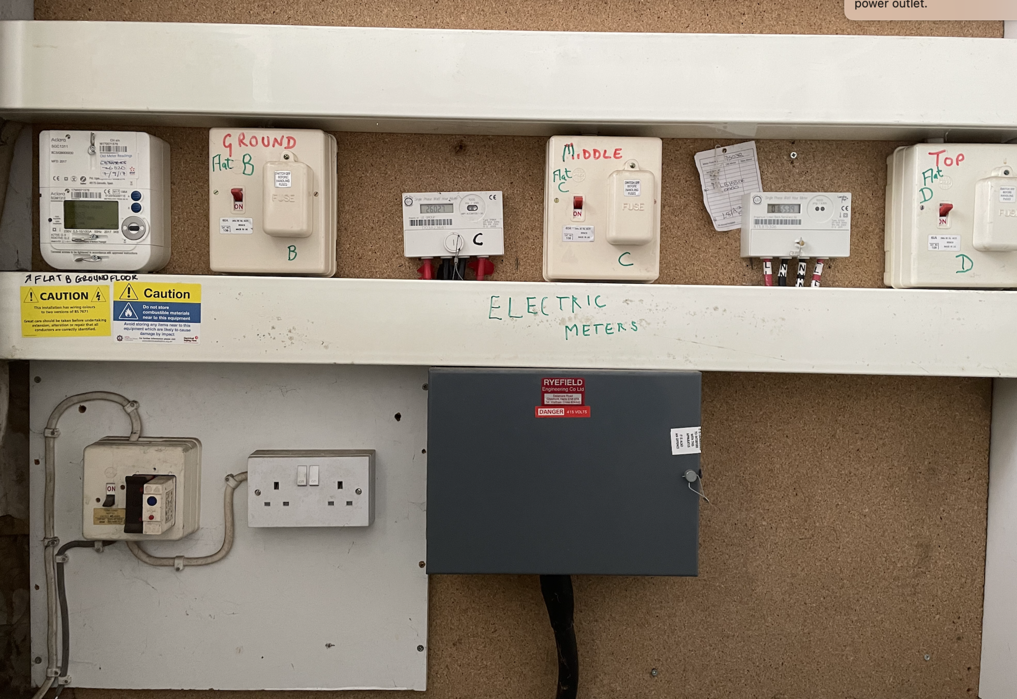

House to 4 flat conversion. Ryefield board in the hallway feeding 3 flats. Weird that the third phase is being used as earth - time to locate the cutout and the 4th fuse....
[ElectriciansForums.net] Cut out mess - who is responsible?
So.... We have a three-phase TN-S supply. One phase feeding the basement flat, two phases being taken to the ryefield upstairs to feed the other three flats. Earthing is a mess but we can fix this. The meter tails for the basement are undersized, we can fix this. The ancient cut out on the far right and tails are redundant, we can fix this.
Now, what I am not happy about is the 'floating' SWA which is neither terminated, supported or earthed correctly. Now the age-old question - whose responsibility? I suspect it is the landlords as UKPN will consider this cut out to be the end of their service as opposed to the fuses in the Ryefield board. Is this correct?

Pretty shocking..poor workmanship throughout how can anyone walk away from that.
This industry just gets rougher & rougher .
The cut out fuses look like REC ..there’s no reason any electrician would use them..FI to ascertain who is responsible.
The run of cable from the cut out to the meter is the DNO responsibility. Can't make head or tail of your pictures apart from the cable size is incorrect. So Isolator for the three phase after the meter (3 ph?) for each flat or what? Then LL supply. Tails from your DB to meter your responsibility.
First question would be where are the meters to define the DNO / customer divide as that currently looks like a case for revenue protection to sort out
Other than that for what looks like a newish service head the DNO earthing arrangement looks like it needs some attention
I would be very careful with trying to sort that job out, it has too alarm bells ringing for me that could result in a lot of grief for you
Sorry guys, here is the missing photo. This is the supply to the top three flats via the Ryefield. A bit old but all looks very respectable... until I discovered the cut out feeding this lot. As you can see the meters are located after the clusterfuck. I'm not intending on getting too involved but I would like to advise the owner (a family member) on how best to approach this.

The DNOs responsibility stops at the first point of connection into the building.
If the meters are local to the cutout, the tails are the responsibiltiy of the energy supplier.
If the meters are remote, as this case, then it's the Landlord, / property owner or in the case of a larger building the appointed BNO, who is the Landlords agent.
A DNO would not have fitted SWA, it would have been concentric or singles in steel conduit when the DNO were responsible for the meters.
As the cutout fuses don't appear to be sealed I doubt the DNO connected the SWA here.

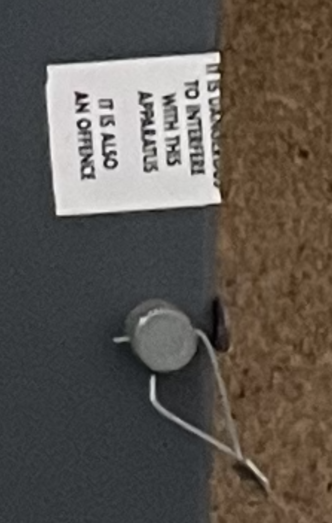

The fuses are sealed along the top. The ryefield board had a DNO seal (see photo).
Given the cut out needs to supply meter tails for the basement flat but also the 'riser' for the Ryefield how best would you terminate? Options I see are:
1) Have UKPN move the basement cutout into the communal hallway to a new 5-way Ryefield. Run a new sub-main back down to supply the basement.
2) Keep cutout as is, run new SWA and terminate into a galv box (or TPN S/F) above cut out.
3) Keep cutout as is, use galv trunking and run everything in singles. (Don't really see the advantage over SWA here?)

Can't see much point having the DNO relocate their stuff. Option 2, redo the SWA properly seems most sensible. But the real reason I'm replying is that if you get to the point of removing the old cast-iron Sanders cutout, I would be keen to save it for the museum and refund your costs to send it over. We haven't got anything of that ilk from Sanders yet and I am not sure I've ever seen that pattern.
I would then say to the DNO, as they are refusing to regularise their own part of the installation, Ok, so it is ok for me to break the seals on the main cut-out fuses and Ryfield box and replace your DNO cable between them then? Can I have that in writing please?
