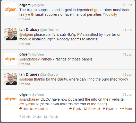

@TedM many thanks for that, based on those responses. - which in my book doesn't properly relate to the TIC as defined in the legislation - interesting to note they don't quote the words from it :) I reckon it still leaves them open to legal challenge if anyone has the wherewithal or possibility of significant loss to do it, especially if they decide to try to apply this retrospectively.
I'd think that the very process of them issuing new guidance where none had previously existed would mean that it would obviously not be legal for them to apply it retrospectively.
Ted asked them to explain how their definition of TIC corresponds with the legal definition of TIC (to paraphrase) and effectively what they are saying is that it just does because we say it does. It is an arrogant reply.
I suppose the next question is what do they intend to do when they discover an 'incorrect' TIC. Options would include:
- Ignore as a historic anomaly
- Use 'correct' TIC going forward
- Backdate 'correct' TIC and clawback overpayments
- De-register installation from FIT database
The latter options would be painful.

The logical thing for Ofgem and DECC to do would be to ignore the current anomalies as they are clearly problematic legally going by the ambiguous Ofgem definition of TIC.
As Bruce points out, these two options: - Backdate 'correct' TIC and clawback overpayments - De-register installation from FIT database would be a nightmare. Presumably there would be enough people affected by enough money for them to consider legal action. And presumably Ofgem and DECC would anticipate this problem.
To pick up Ted's question, MCS had a couple of drivers making them ask the question I suspect. DECC asked them to include the TIC field so they were probably asked by a few installers what to put there. Also I think MCS was one of the organisations Gavin asked when he had a customer involved in a dispute on the TIC point.

It would be nice to know what DECC intend to happen when installations are found with a 'incorrect' TIC as I outlined in an earlier post. It would not surprise me to find that they shrug their shoulders and say it is a matter for each individual FIT supplier.
correction - my customer contacted EST before contacting me, who then contacted MCS and potentially set this whole process in motion - well, Julian also had a situation at the same time and pretty much took over the discussions with Ofgem.
I had a feeling this would come back to bite us again at some point if we didn't nip it in the bud then.
I'm happy to follow this up with DECC via FOI if there is any more information you think will assist.
It may even be appropriate to go direct to DECC (disregarding the FOI) and attempt to start a dialogue. The FOI response I have is from a James R. Marsh who describes himself as "Policy Adviser, Feed-in Tariff team" at DECC.
