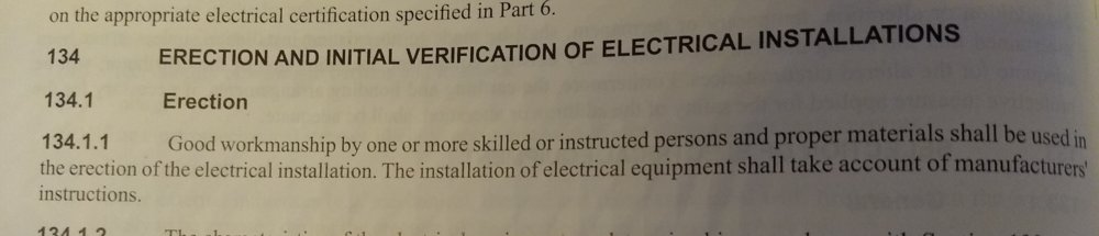

Depends what part you read
VERIFICATION OF ELECTRICAL INSTALLATIONS
134.1 Erection
Regulation 134.1.1Good workmanship by competent persons or persons under their supervision and proper materials shall be used in the erection of the electrical installation, Electrical equipment shall be installed in accordance with the instructions provided by the manufacturer of the equipment.
134.1 Erection
My blue book says this, and so did my yellow one. You have quoted from an earlier version of the regs.
‘Twas in the green one that said, ‘shall be installed in accordance with’, I believe.
Yes he has, I read the new regulation (new with Amd 3 of the 17th) slightly different to the old. Now we have to take the MI into 'account' which I read as the electrician having more of a choice rather than sticking rigidly to the MI as in the older regs that @Markyd has quoted from.
