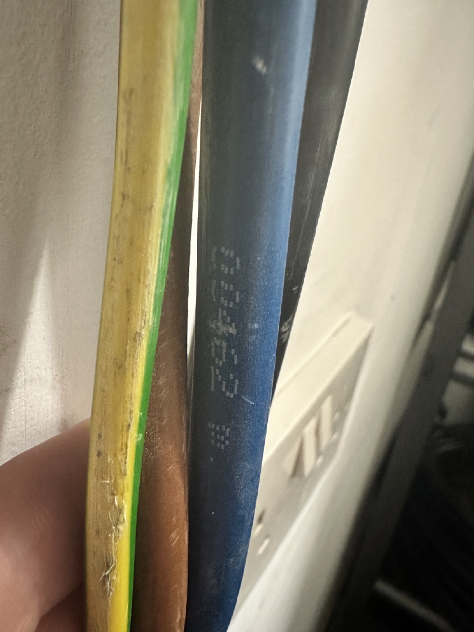

No obvious markings (either inside or in the meter cabinet) on any of the tails, other than what's in the following images (00462 ?)...

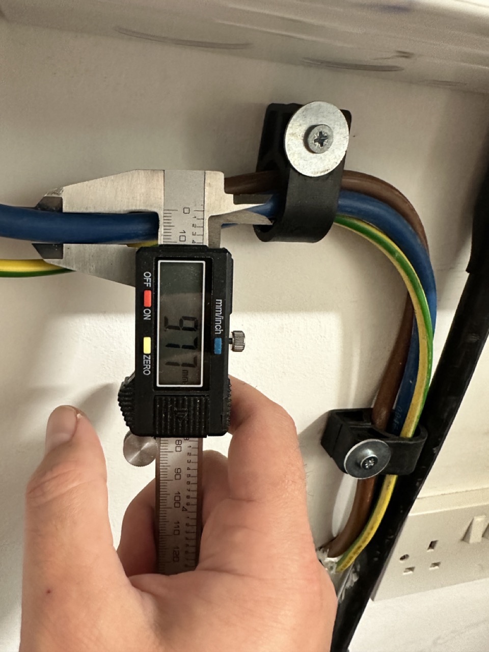

Does the outer diameter give any clues as to whether these are single or double (single/sheathes that is)? I do think either way, I'd have expected it to have been brought into the box either from behind or in some sort of conduit. Not just for looks, but for safety given that it's a well-used part of the house.

Not very often to see core colours on the outer sheath…. Usually grey with the colour on the inner insulation.
Where are these tails going? Might have been more suitable to use armoured cable, as there’s smaller armoured cables coming out.
The “00462” I think is the metre marking from where the cable was taken off a much bigger drum. You might find “00463” a metre away.

It looks as though they are double insulated flexi tails, hence the colour.
Meter tails or other insulated and sheathed cables, the basic insulation over the conductor and the non-metallic sheath are deemed to comply with the requirements for both basic and fault protection in Regulation 412.2 and hence don’t need to be installed in containment (unless required for mechanical protection). What this also means is that removal of the outer sheath to enable the colour of the core to be identified outside of a wiring accessory (e.g. a meter or service block) should not be done, as the cable will have been reduced to having basic insulation only.
I would be looking at if the tails run through the fabric of the building as to whether it needs some protection.
25 mm² flexitails are 11 mm diameter, 16 mm² standard tails are 9.1 mm in diameter. Although there is going to be some variation in those numbers due to manufactures.

Thats no real excuse especially when you have exposed tails buried and clipped up walls.
You assume the tails are in conduit and I also assume that your assuming that the conduit is earthed.
Turning the power off in your case is made simpler by the fact you have no main fuse seals making it easy to pull the fuse.
I can’t believe the meter installer left the tails in blocks without even the thought of using an isolator, which would have been easier to fit and probably cheaper and left the seals intact.
Getting back to the issue at hand, I'd rather protect surface clipped tails drilled straight through a wall, than have them buried. Bear in mind these are protected only buy a fuse rated between 60-100A, although I suspect original tails run a short distance up the cavity and aren't buried.
@Aaron b raises a point I'd tried to look into earlier, which is compliance of protective devices installed within tesla gen 3 wall connector. I didn't get to the bottom of whether or not it's compliant with BS7671 and it may well be - I simply can't find info on it.
Trunking or chased with metal plate.
