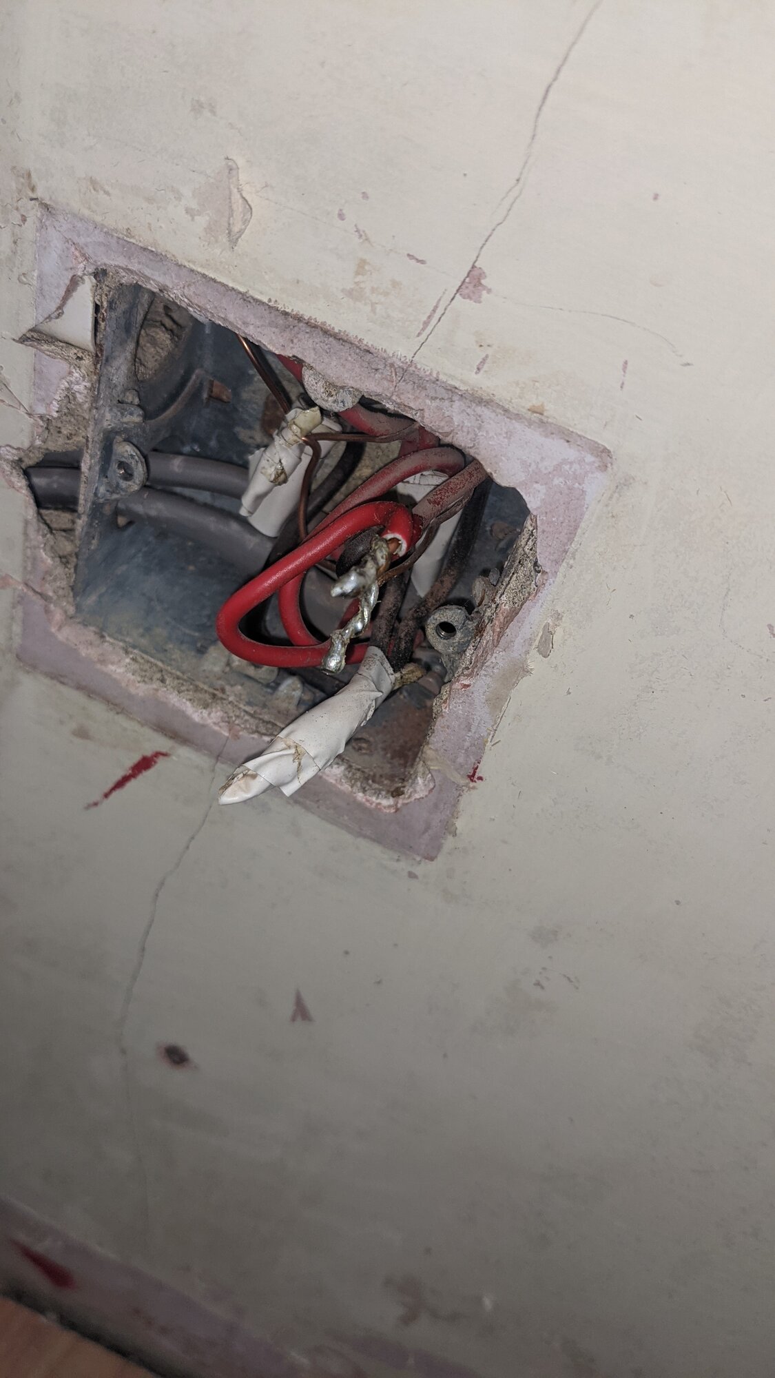

may well be burnt contacts inside the switch causing excessive heat.
Could be. Though about 2mm of the solid link was clamped on the insulation. I think because there's no "give" in the solid conductors, it's not as forgiving.
Have to disagree with you there. No copper creep on solid conductors, although they can't carry as much current as stranded ones.
What I mean is, because there's no give, if the flat clamp cage is (partly) on the insulation, there will be very little force on the copper: the cage will be tightly clamped to the insulation. On stranded conductors, because they move about as you tighten the clamp (partly on the insulation), you're more likely to make at least some connection with the copper.
But I agree with you about the creep. :)
Yes, the creep is always a problem...Jimmy Saville for one.
Seriously though, I do understand creep in cables, but I was wondering...if a clamp is skewed, so is touching insulation and the copper, is a tight connection that way better then one which is making full connection with the copper but not very tightly?
I would tend to favour the former, as there would maybe be lack of movement, whereas in the latter, you have a bigger area to exploit arcing?
Please, don't hit me! I am genuinely interested to hear your views.
Steve, it looks like a storage heater distribution board judging by the 16a MCBs and 2.5mm circuits ? A combination of cheapy board, poor workmanship and a substantial load for several hours a day would certainly cause the problems found.
I think we'd be better off using metal boards to reduce the risk of fire in such cases. Oh hang on a minute.... :D
Hi Pirate - the correct mm2 contact area is critical to avoid heating and the pressure from the clamp ensures the contact is maintained over time etc. Without both the result is an unpredictable failure, imho :) .
