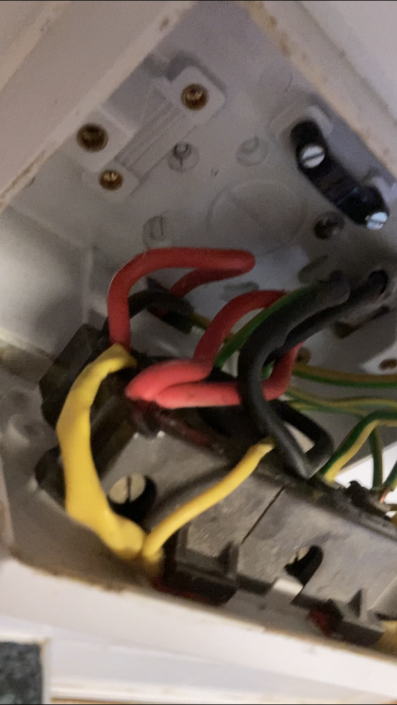

Trunking just behind a gas hob
And when it was changed to gas, connections were just cut, the 45A switch was on when I arrived, live conductors millimetres from the metal oven housing.
Edit... don’t worry though, this happened before a 2017 satisfactory condition report which didn’t pick it up ?
