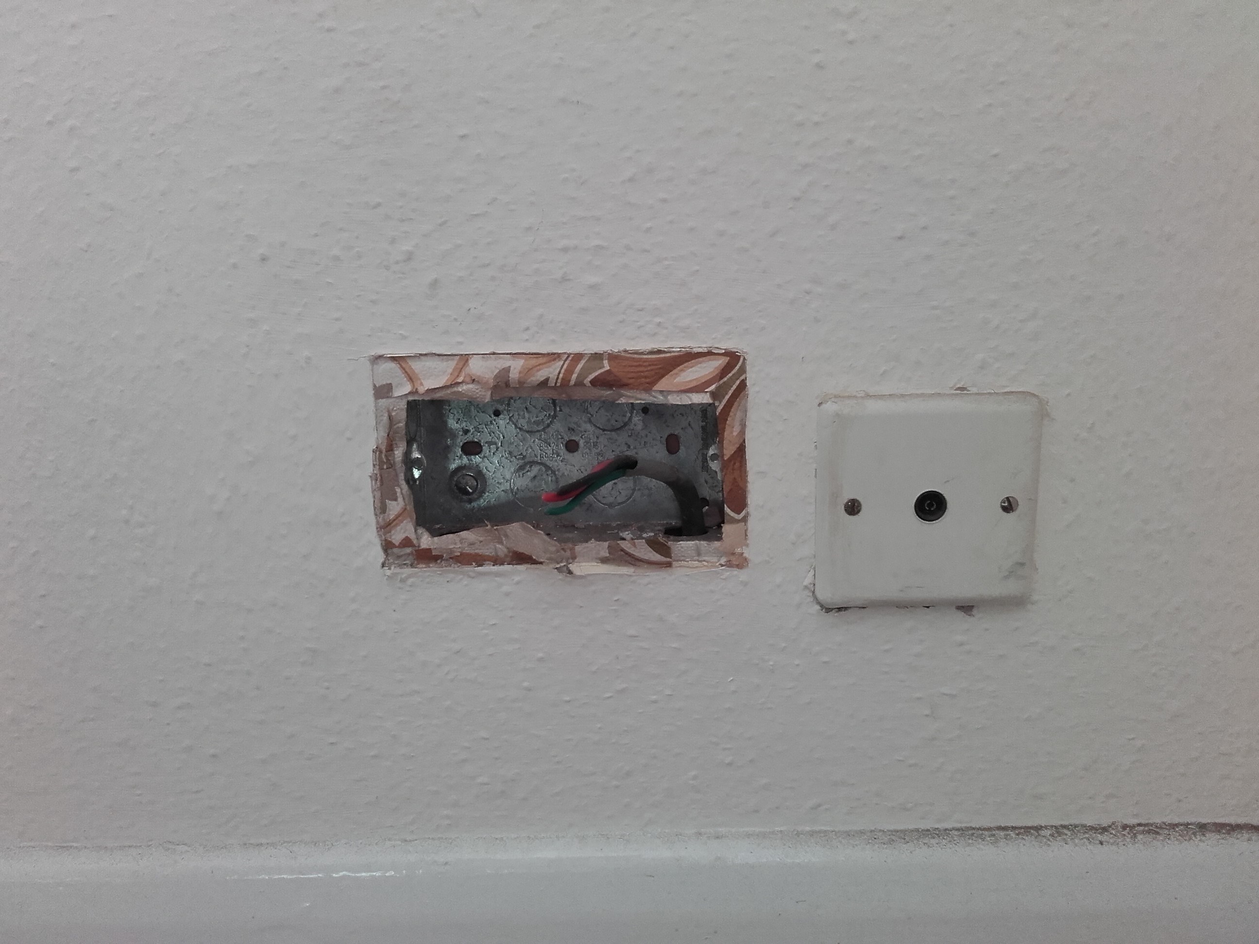

Bathroom Light fitting
Two way lighting circuit
Routing of cables

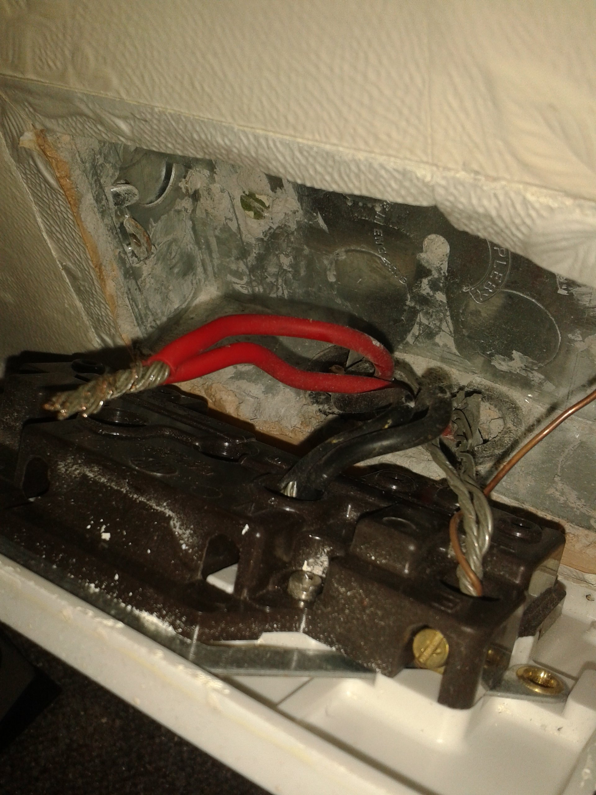

In service Junction box
In service junction box

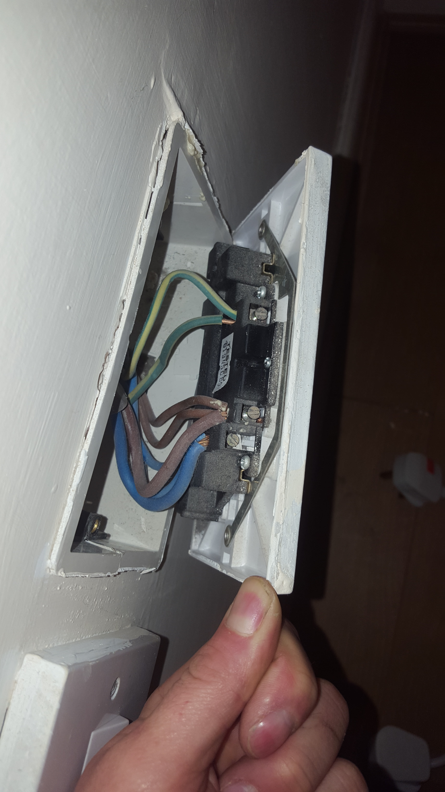

Socket fixing
Two way switch
All these photos were taken today prior to me doing any rip out or start over! This is the state of just some of the installation after a "full re-wire". The owner of the property wasn't just ripped off but actually put in danger!
