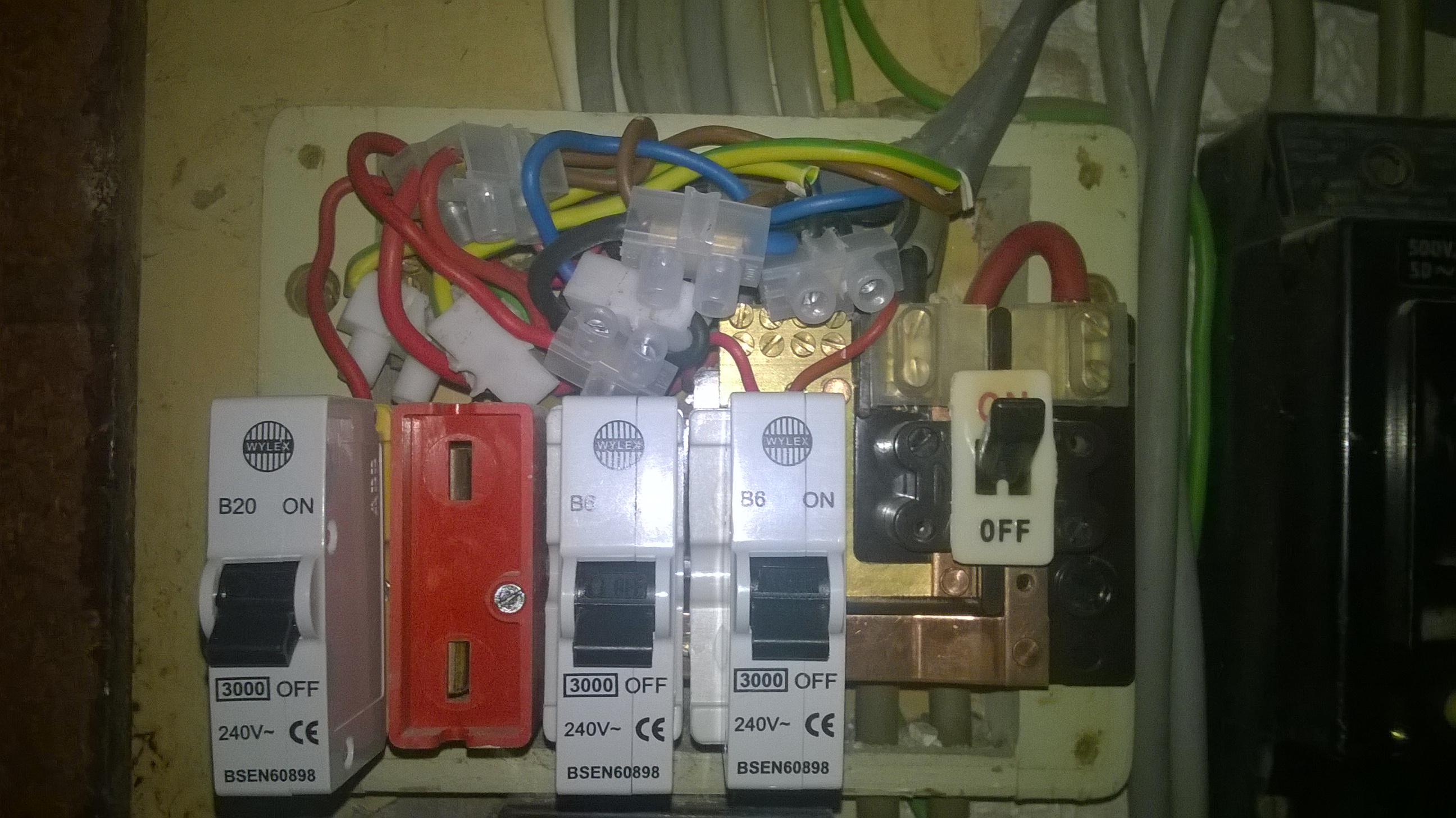

[ElectriciansForums.net] Dodgy trade pictures for your amusement! - 1 Million Views!plumber had fitted another C/U from the existing, but had removed the meter cabinet to drop the cable to the shower into the cavity ?? then forgotten to reconnect the main earth
the whole thing was nasty
no CPC on the lighting circuit ( pre66) and metal fittings and switchplates everywhere
grommets absent on tails
DNOs earth pulled away from cable ??
lovely bit of termination aint it !!!
cold water feed to shower, missing cover and water flowed down into the terminals ?
oh and the shower switch was inside the shower as well

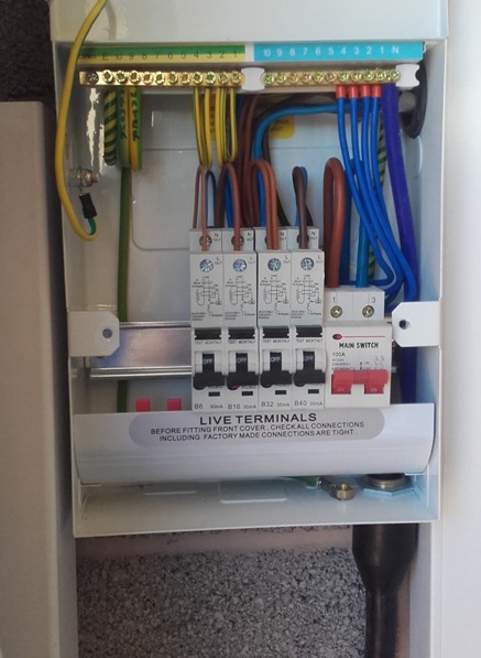

Heres a nice one
doing a favour for the family, I went to look at a house a young couple had bought, when I opened up the C/U all of these beads fell out, the main tails inside the C/U were melted due to polymer migration and high temperature
the origional cables had been dropped down in the wall cavity
as well as this metal light switches and fittings and no CPC and some amazine other bodges by barry the big mouthed know it all builder
where the new cables passed through a wall, the muppet had covered the big hole with a tin of PU foam and filler ?
There was an SWA in the garage, but no evidence of it inside the house, or a termination into PVC, until I lifted the floor and found this wonderful job
the C/U when removed showing damage to bus bars insulation
the C/u in the garage with the SWA nicely terminated
