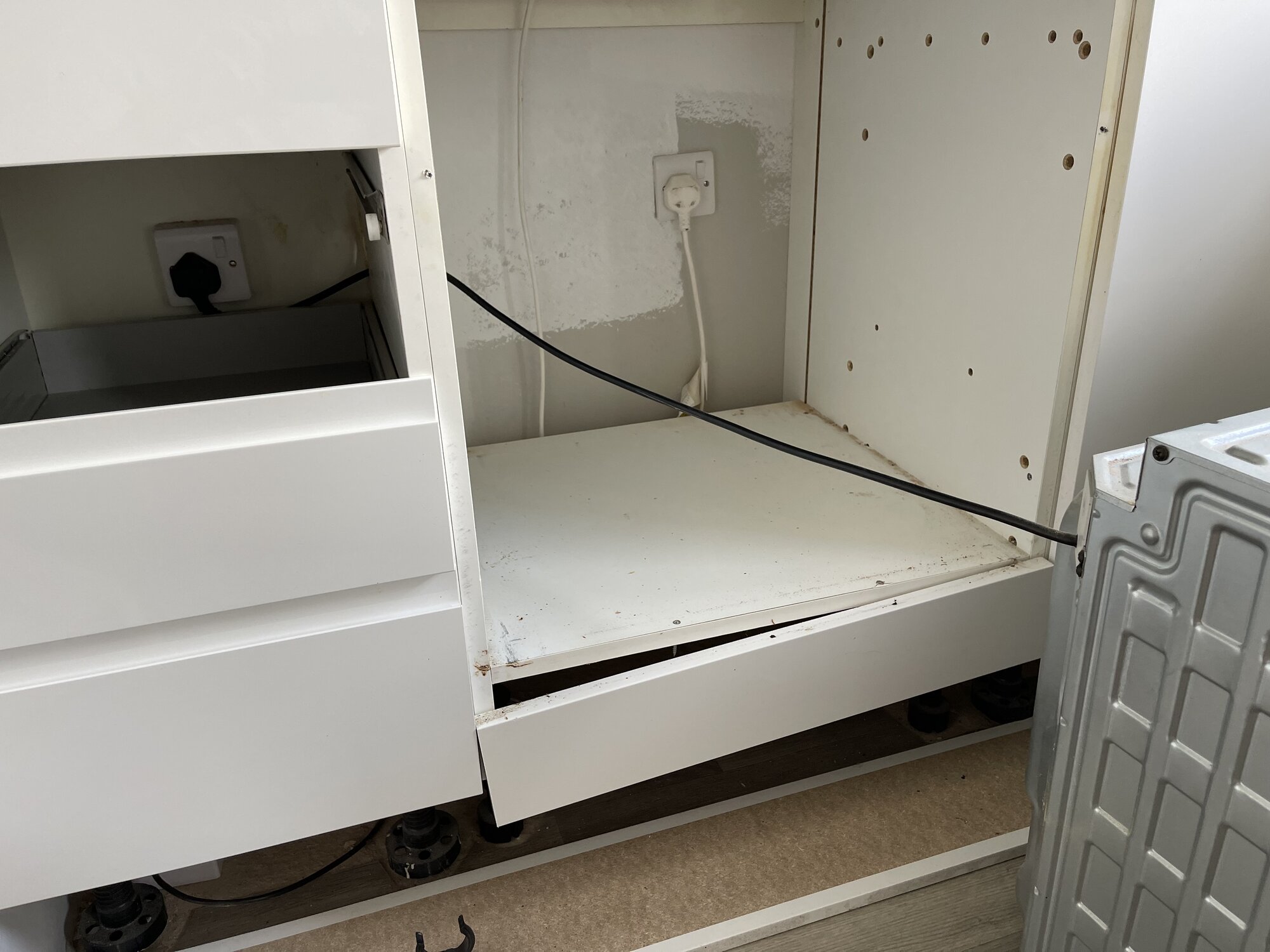

Doing an EICR and found this. Newish build too at 3yrs old. Owner never had any paperwork prior to today and it’s going to be rented out.
Novel way to use a cooker socket for a gas hob igniter. So the gas hob is on a 32a circuit of its own. Plug wired in 6mm
Cooker/oven is on its own 16a radial with the fridge.

The socket is fed in 6mm from the cooker circuit right? And the hob has a plug with a suitable fuse fitted?
The socket is the cooker circuit. It’s had the outlet plate swapped for a single gang.
Yes the plug has a suitable fuse in.
Not saying it’s a problem. Just an odd way of doing it considering that’s how it was done from new.

Yep, nothing wrong with that. All the houses on my 1970s built estate were the same, ie. wired with a 30A 6mm circuit to a single 13A socket in the kitchen. The option was given when buying the houses of whether you wanted a cooker switch fitting instead of the socket.
