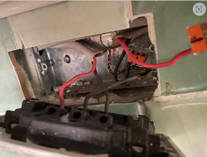

Fault tracing a tripping B20 RCBO with a sockets radial, giving L+N to E IR of 0.03M and some interesting crackling above the kitchen ceiling when I tested it! Flat roof above....
When breaking down the circuit, this is how I found this socket:
The next socket one along was the last one testing clear and the cable changes from grey to white between the two.
(For today I left all but two sockets connected and finished up with IR of 176M.)
