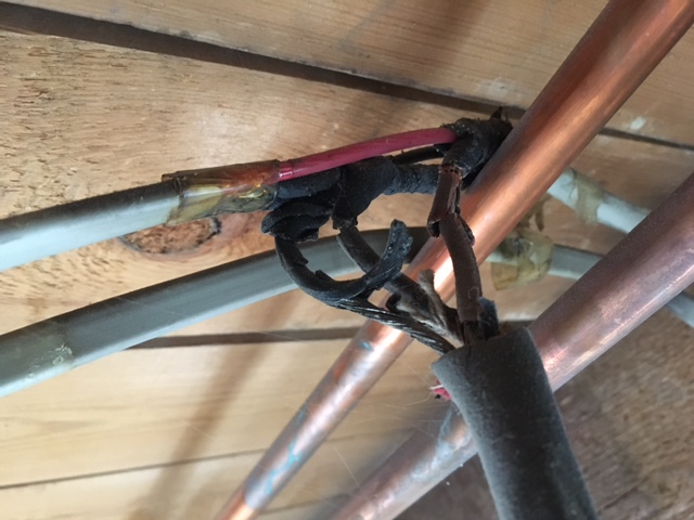

Lucky escape! found this in a ceiling void, nice VIR-PVC joint with crumbling insulation
Live conductor within a whisker of the bathroom towel rail pipework

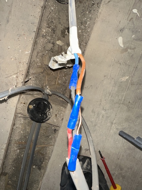

Called by customer to help a flat was being part rewired after a flood - the chap doing it hasn’t come back - spent half a day trying to figure out ring main cables and sort out rerun cables - anyway found 3 crimped joints new onto old cable this is one of them …… had several joints like this…
By time I had finished rewriting there were no joined cables
Tell me that Crimp joint wasn't the finished 'signed off' job...

Hi nope ‘half job’was still to be finished when I arrived 3 rooms still had old cables and original sockets. However, this was a finished joint as it was covered in insulating tape and tucked away under floor board - spotted when trying to trace ends of the ring main and figure out what had been done.
U will be pleased to know I ripped out all all the old cables (and scary joints) and replaced with new ones only took us a couple of hours once sussed out.
Also what was also disturbing - at the consumer unit the ends of the wires were still connected into the breaker (switched off but no lock off) - should’ve been disconnected - which i immediately did for testing and safety..

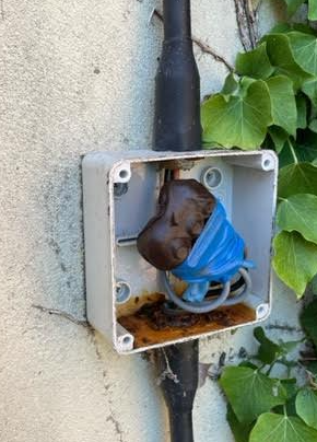

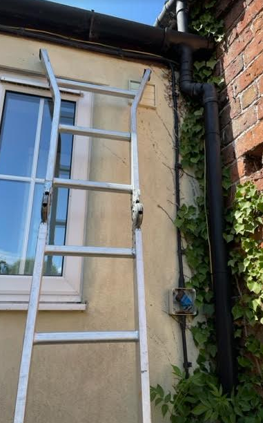

Was here a week ago, didn't take cover off box last time. New outdoor socket requested.
Last time I found the other end of the circuit:
It was still live, so I turned off the breaker marked "Shed", it went dead, and I arranged to come back.
A week later I return, and am told that the freezer stopped working after my last visit.
What I failed to spot was it also goes through the wall, and back in, into a lone double socket. Genius circuit design, sticking the freezer on with the shed on a shared RCD.....
