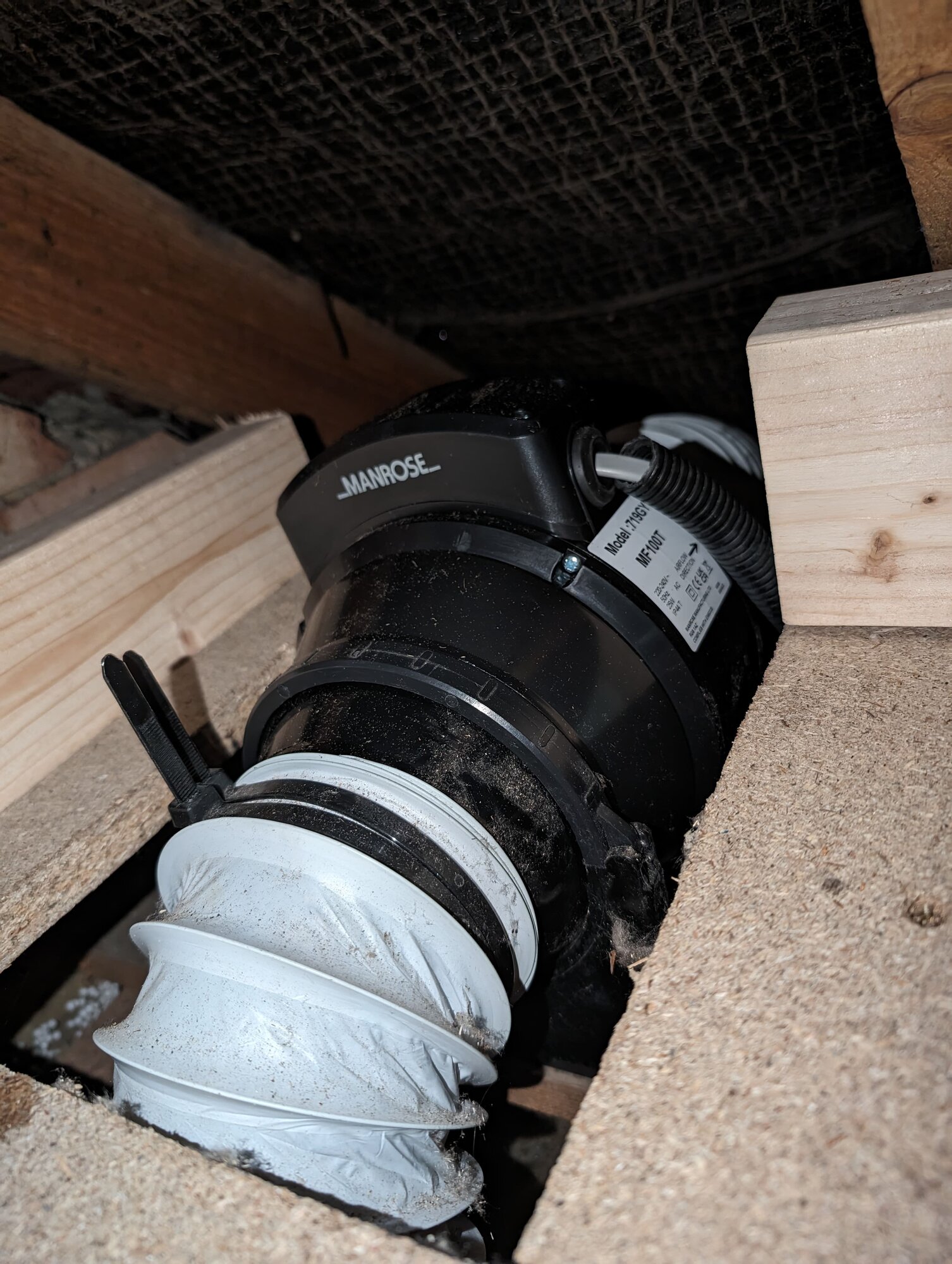

I turned up to change an outside light. This was the supply cable as I found it and the photograph to explain to customer why it needed to be a bigger job. Needless to say I took it out of service and ran a new cable.
When the place was rewired I think no one fancied tackling the slate roof to replace it.
Twin (without earth) and tinned copper conductors, so it's probably sat here in its buckle clips since the early 60's
