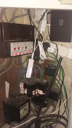

They blew a few 100 amp fuses in the communal fuse cupboard, that is next to the main door to a block of flats

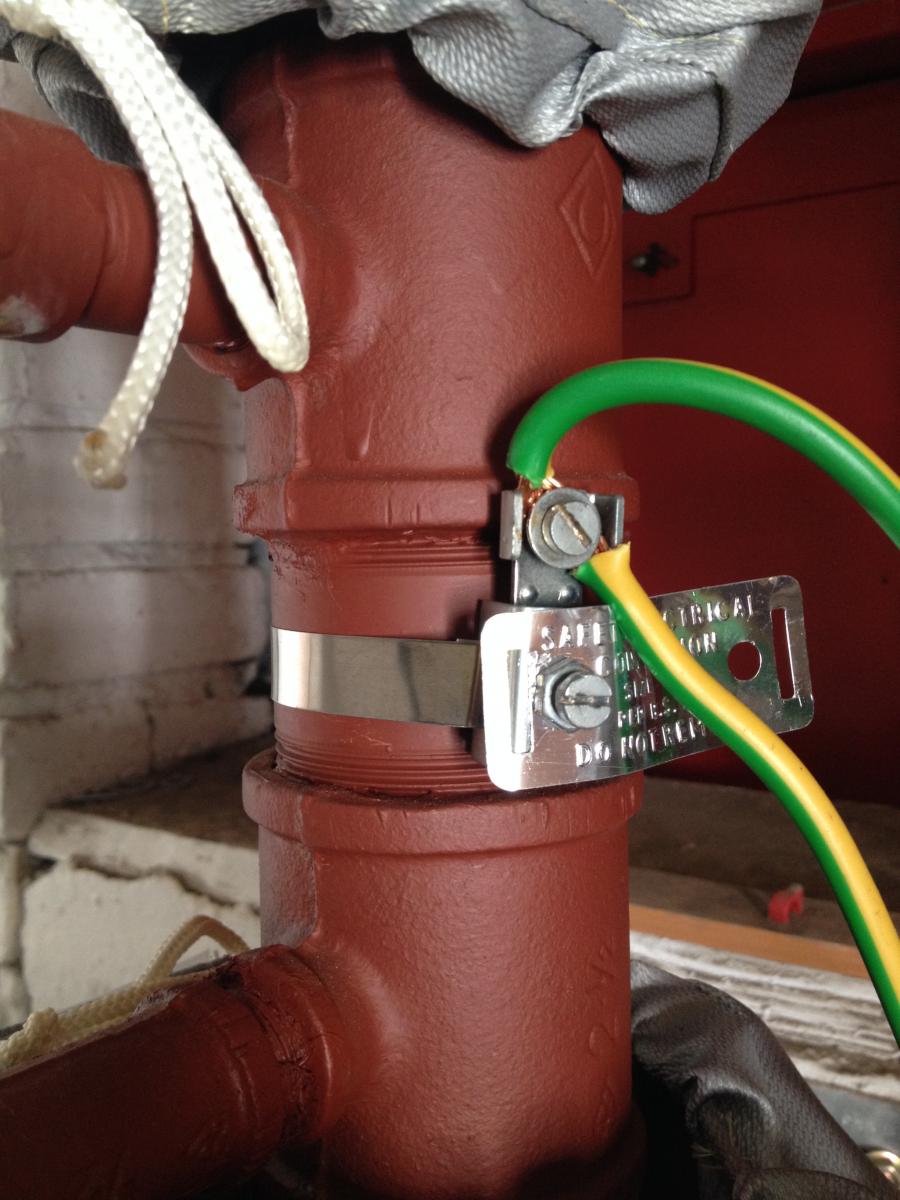

Here are some more from the alleged safe install & these were in plain sight to the Supervisor
In the 1st pic, you might just be able to make out the MICC PYRO cable under the orange cable clip at the bottom right of the board, it is close to the two wires though
These next two are of the temporary MICC PYRO cable
This is how the fuse box looks now
EDIT:
I forgot to add the list of faults found within that installation was no less than 18, I was writing them down as inspector discovered them back in 2011 refurbishment program
  1. Dust cover left over the Smoke Alarm

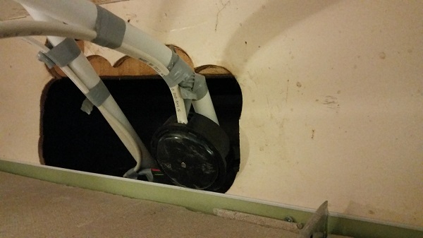

  2. Smoke Alarm wires exposed via a hole in living room ceiling

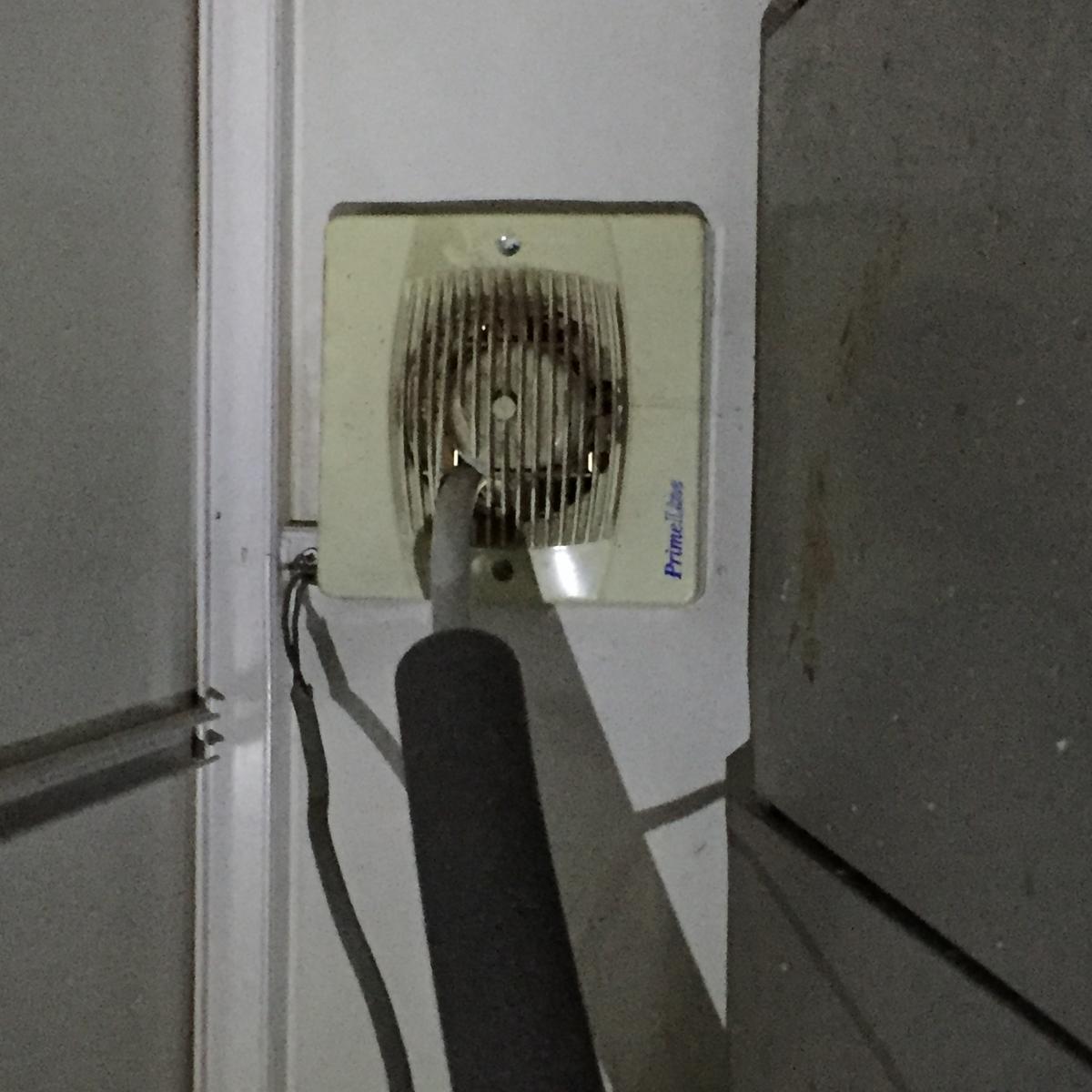

  3. Extractor fans are not wired correctly
  4. Missing and unchanged units for extractor fans (in airing cupboard)
  5. Extractor fans set to wrong settings
  6. Extractor fans not fitted correctly to the wall
  7. Possible wrong external wall vents for extractor fans 2 different types of vent exist at present time
  8. Cables in airing cupboard connected with a connector block, taped with insulation tape exposing the bare connections to the connector block (in airing cupboard)

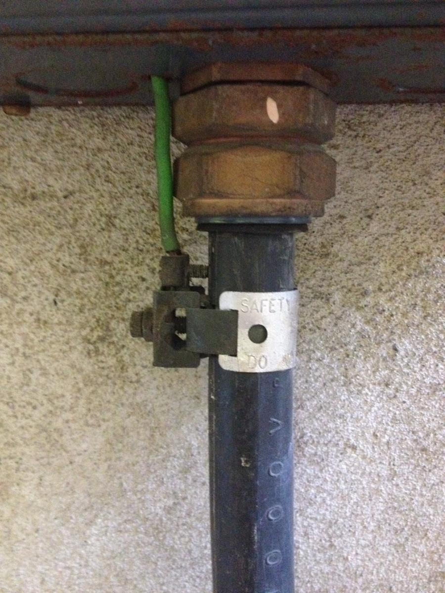

  9. The hole drilled into the mains Mineral-insulated copper-clad cable (MICC PYRO) cable (in airing cupboard)
  10. The damage caused to the fuse box because of the hole drilled into the mains (MICC PYRO) cable (in airing cupboard)

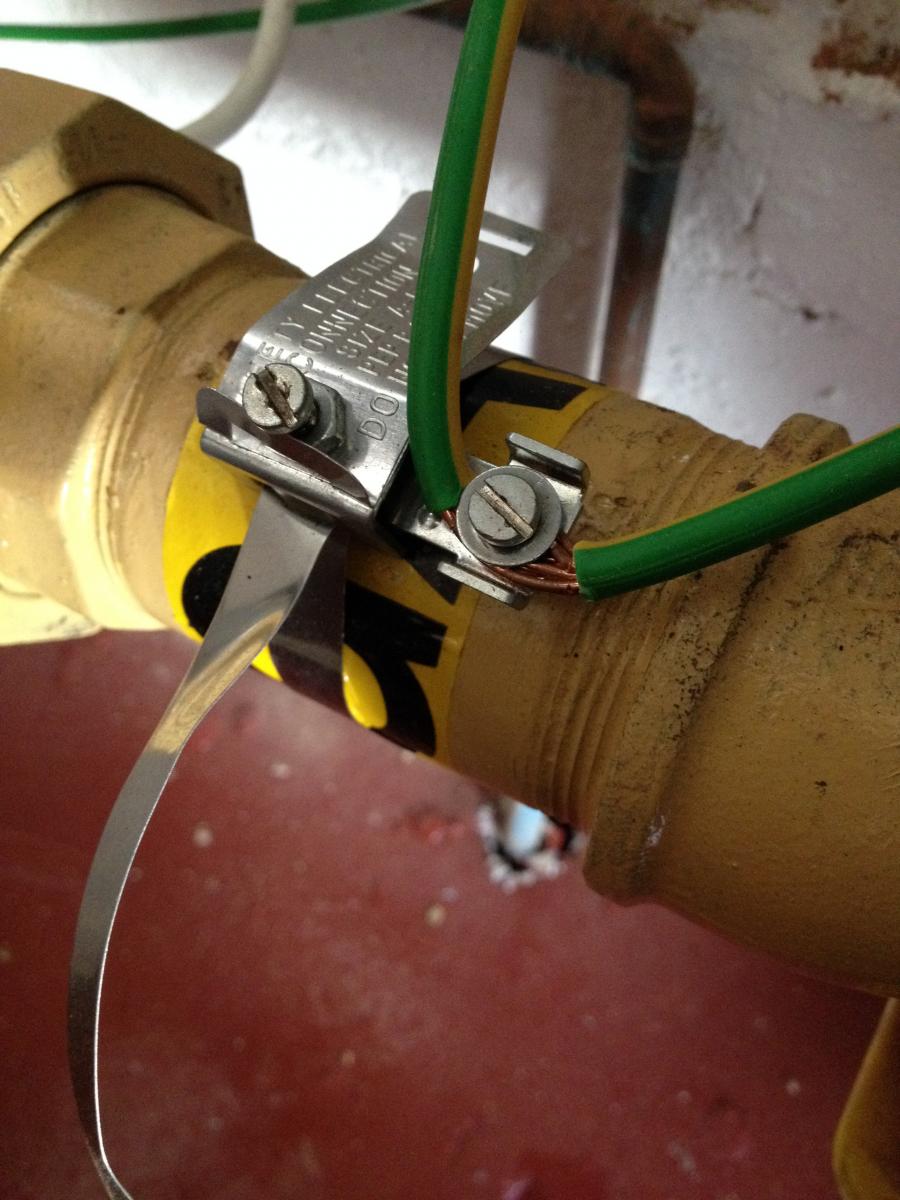

  11. Earth cable incorrectly and loosely fitted to the main gas feed on gas meter to the boiler and cooker (in airing cupboard)
  12. When using the microwave the lights in the kitchen flickers
  13. There is a 13 amp fuse fitted instead of a 3 amp on a fused light switch

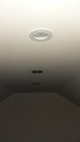

  14. Changed outer sections of light fittings but not the internal fittings
  15. Electrical cables exposed via a hole in airing cupboard ceiling (in airing cupboard)
  16. No trunking for cables adjacent to gas and water pipes (in airing cupboard)
  17. Cables are overhanging the prepay electric meter adjacent to where I place the payment key to top up or access emergency credit (in airing cupboard)
  18. Missing 3 blank off’s on the fuse box (in airing cupboard)

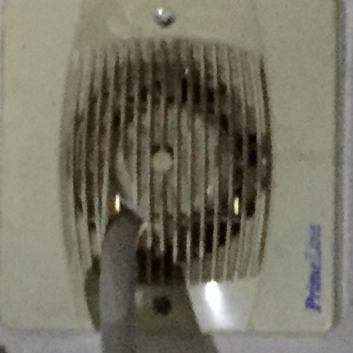

Only 2 weeks ago they got round to changing the vent grill from a flap type to a slotted type & said I had the wrong extractor fan in the bathroom as it should of been a humidistat, hence my query in the other thread & again the extractor fan in the kitchen was allegedly wired up incorrectly, now I have two speeds (Trickle & Fast, with switch in on position & 15 minute fast in the off position reverting back to a trickle) to the kitchen fan & no off switch unless I isolate it at the RCD & it turns off the main sockets.
The Bathroom fan shares the same RCD as the Lights & the Smoke alarm
