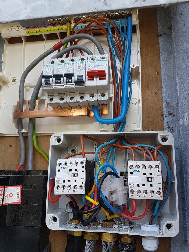

Replacing another DB in the same place, the old one seems to have suffered a small burnout where someone forgot to do up the neutral test link.
In the same board the main switch was replaced with an RCD at some point, outgoing neutral was connected to the neutral bar with 3 cores from the inside of a 2.5mm armour. Quality from start to finish.
Nice boards Merlin, the new Schneider are nothing in comparison, look pretty on the outside but poorly designed. The idiot that thought putting the earth bars in layers needs a good kicking, especially when it comes to the larger boards that have 3 layers! Saying that I'd rather fit one of these than the flimsy Hager 3ph boards.
I'm part way through with the replacement, but need to fit the correct meter add on kit as the one supplied is wrong, Fortunately the 35mm supply armour had loads of slack so I was able to leave the conductors long ready for the correct meter. Still some bits to alter and labels to add etc.
