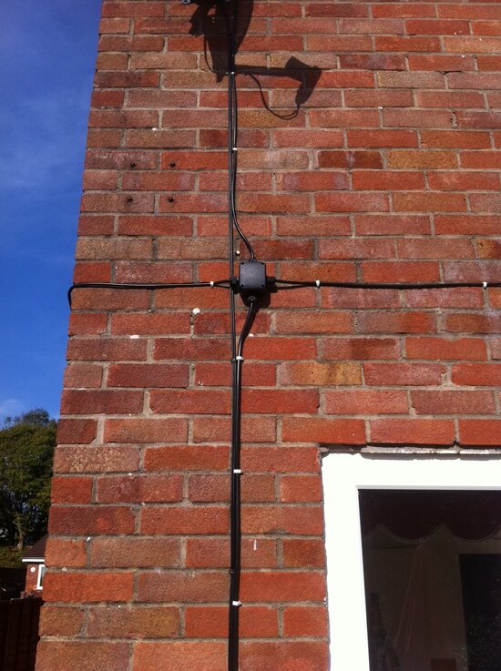

Hi, as you can see by the photo ive got a supply coming down to a JB on outside wall then it splits 3 ways. 2 left and right go to security lighting and down is a SWA 1.5mm going to a light in a shed near by. This circuit comes straight from the cu and is on its own 6A MCB.
Can you spur off in 3 directions?

If you can’t a lot of houses would be condemned.
So long as the earthing arrangements and containment are up to scratch then there’s no problem.
It may not look pretty but I don’t think aesthetics come in to the realm of BS7671

Perhaps you can tell us why it can't go off in three directions, ...as you put it??
