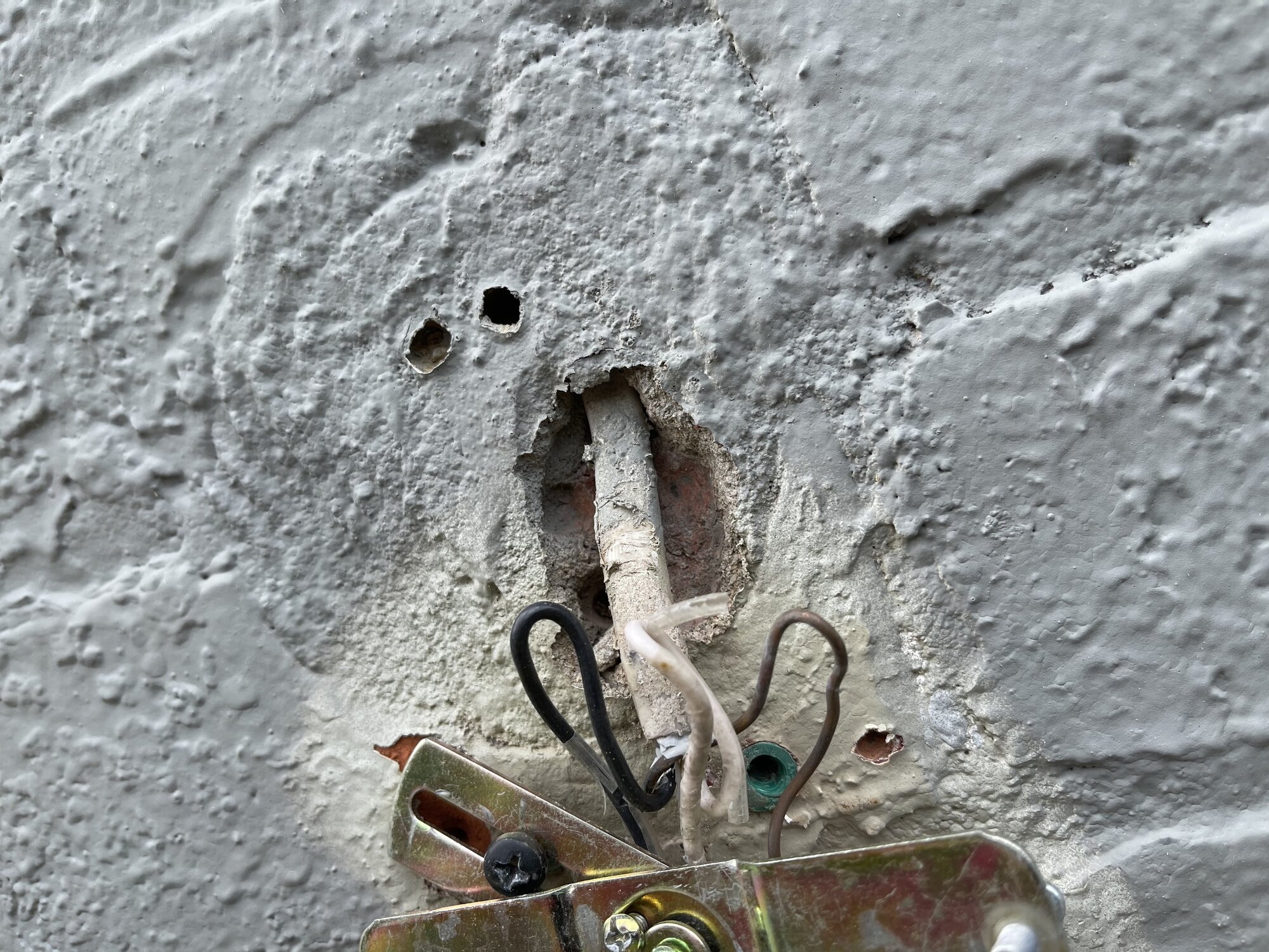

My wife and I recently purchased a house and every electrical related item I go to replace seems to be installed incorrectly... I want to put a new porch light outside and it seems they did not install any sort of junction box. The house is brick and would require that I drill into it to create the space for the box.
I'm guessing one of three options needs to occur:
1. Install a junction box embedded in the brick before installing the new light
2. Install a junction box on the exterior of the brick, no drilling required
3. Purchase a light that has some sort of built in junction box and simply attaches to the exterior brick
I think I need to do 1, but could someone set me straight? And if 1 is the way to go, any suggestions? What is the best way to drill into the brick? Do I need to use mortar to secure the box?
Tips would be very much appreciated! (I do have pictures but couldn't figure out how to upload them)

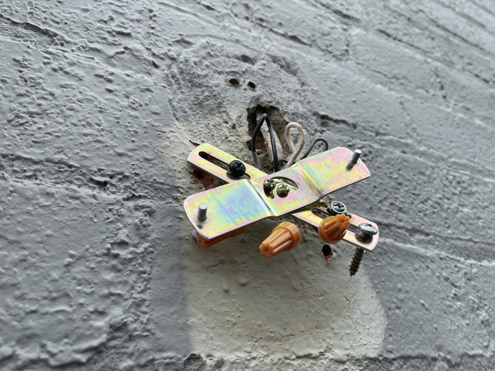

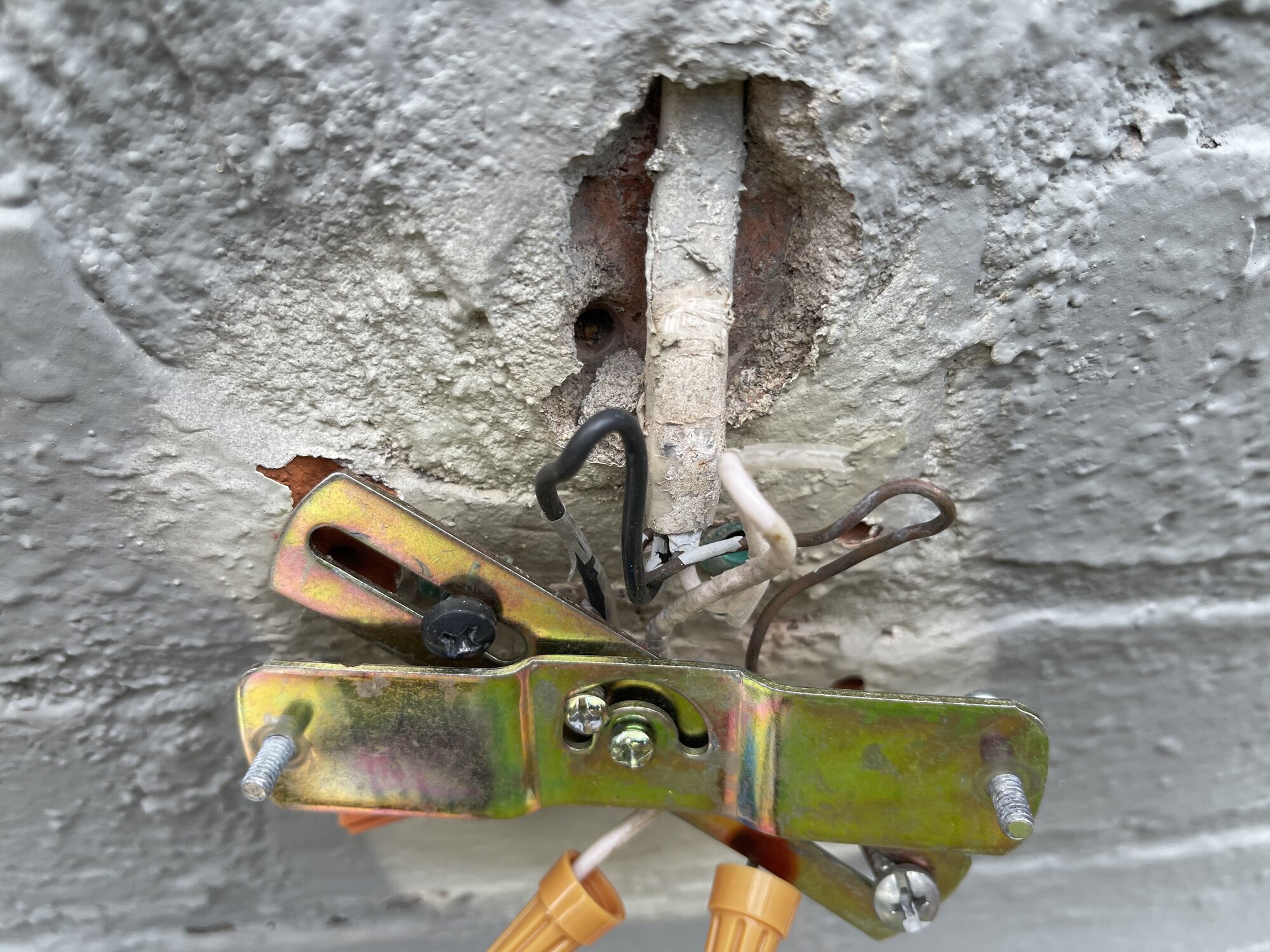

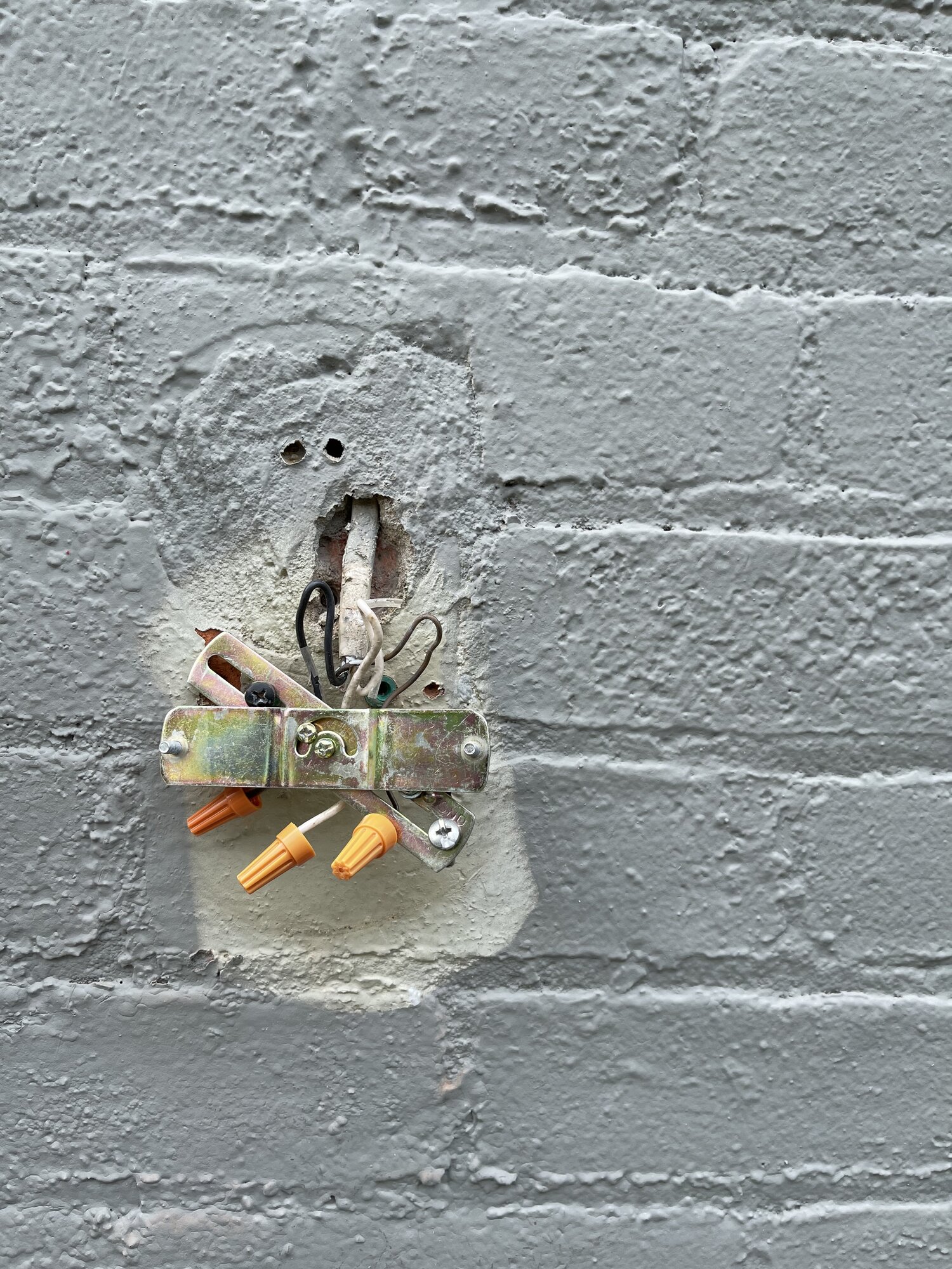

There was an existing porch light hooked up that I took down. I've attached some pictures!

Just connect the new one to the existing cable.....you're third option. The new light fitting will have provision for connecting, as per that removed, plus some method of fixing to the wall.
The wires don't need to be housed in a junction box? They can just be connected directly?
You will need to mount a surface mounted box which Lowe’s or Home Depot has them. Go rent you a hammer drill and buy you a box of blue plastic anchors which already has a 1/4 inch masonry bit with the anchors. I run into this situation all the time. That job I could do in 10 minutes. If your going to work on your own house then bring everything up to code. Good luck
Awesome! Thanks so much for the quick reply.
So would something like this work?: https://www.lowes.com/pd/RACO-1-Gan...w-Ceiling-Pans-Ceiling-Electrical-Box/1099827
I would run the cable into that, wire it to the sconce, and mount the sconce against the pancake junction?
