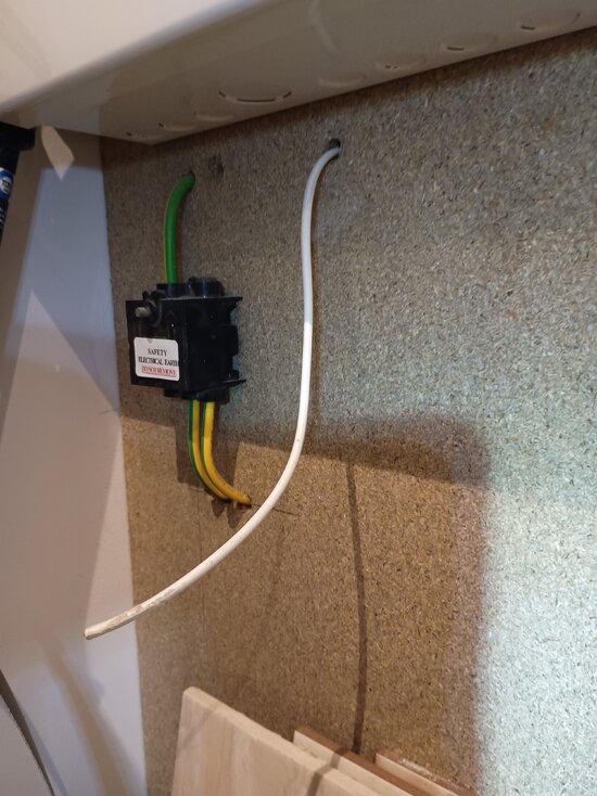

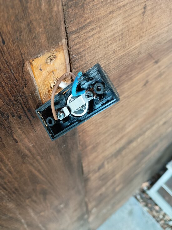

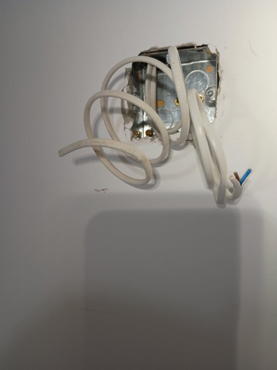

I want to install a door bell (front door). Cables have been installed (not by me) see attached photos.
There is a back box in the wall of the hall with two x 2 core cables coming out of it.
There is a single 2 core cable for the bell push at the front door -I have unscrewed this to show the cables.
Also there is a single 2 core cable coming out just under the consumer unit in the utility room adjoining the hall.
How do I proceed with connecting up a door bell

From what’s there, you would also need a transformer to power the doorbell circuit, which would mean taking a 230V supply from the consumer unit.
Being a new circuit, albeit only 12 inches long, would still require testing and the services of an electrician.

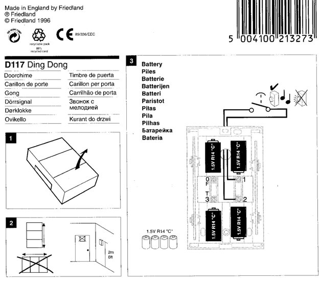

Just to follow up on the 'ding-dong' option that Friedland have been making for years, if you put batteries in one of those, all you would need to do is connect the cable from the bell push to the two terminals in the chime (example below), screw it on the wall, and job done.
That is on the assumption that your bell push does not have a light in it. If it does, you would need to add a transformer (or take the bulb out of the bell push, as it would flatten the batteries in no time).
I'd expect batteries to last for several years (unless you have hoards of visitors pressing the doorbell every day)
