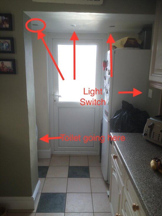

I have just recently completed a city and guilds and am a trainee electrician. I was wondering if I could ask a question about something that has come up with a customer.
The gist is that the customer has just had a new downstairs toilet installed at the back of their kitchen. It is basically a small 'lean to' extension that they have converted half of into a toilet.
They now wish to have a single downlight and extractor fan installed.
I have no issues with wiring this, however, it's getting the power to it that concerns me.
On the wall opposite the toilet is a switch that controls two downlights.
Is there anyway I can use the feed from this switch or the one that goes to the lights it powers?
Obviously I would need the existing switch to still only power the two downlights it currently does and the new switch to power the extractor and fan in the toilet.
Apologies if Im not explaining this very well, i have added a photo taken before the toilet was installed, you can see the two lights that remain outside toilet and where the switch is....
Thank you for your time, I really learn a lot reading these pages.

A few points to note!
Your fan will need a means for local isolation, usually a fan switch, also the fan will more than likely require fusing down to 3amp as per instructions so the usual method is to pick a mains of the lighting circuit and run it through a fused spur to supply the toilet light and fan.
You will need to be able to supply the toilet light and fan with permanent line (and switched line) and neutral so you would have to find out where the permanent supply to the existing downlights is located and work from there.
I would tend to put the switch in the toilet area for convenience and to stop someone inadvertently turning it off when in use.
