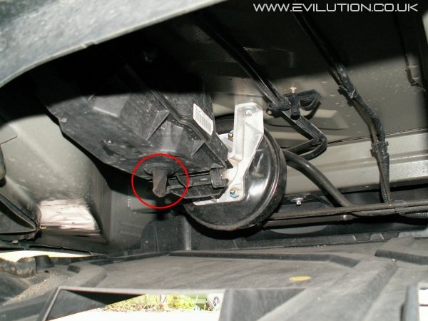

I have seen some watertight seals which act as a drain as well, Car ECUs use them mainly.
They are a water tight gromit which sits where you want the drain to be, and they stop water from coming in, but they let water out.
They have like 2 little lips (best way to explain them) which in their normal position they are tight shut, but when water from inside the enclosure touches them it lets it drip out slowly at the same time as keeping a water tight seal.
Here's a picture of one
They are mainly used in the car industry to keep water out of electrical components like ECUs, Starter motors, Alternators, etc.
They should work as we are not coming into contact with electric with them, they are a simple drain to stop water coming in, but letting water out

I have seen some watertight seals which act as a drain as well, Car ECUs use them mainly. They are a water tight gromit which sits where you want the drain to be, and they stop water from coming in, but they let water out........
untitled1.jpgThese devices (duck bill valves) would make sense to me in an enclosure, at least the original IP integrity might be maintained or at worst it would solve the insect problem.Hmmmmm, maybe a business opportunity for some budding entrepreneur there??? Come up with one that can be fitted into a standard IP 66 20mm gland by removing the compression seal. When you make your millions you can just throw 1% royalties my way. :)

Nicholas Owen Wrote "They have like 2 little lips (best way to explain them) which in their normal position they are tight shut, but when water from inside the enclosure touches them it lets it drip out slowly at the same time as keeping a water tight seal".
This design is also used extensively for HVAC condensate drains - Known in the automotive industry as "Donkeys Dick Drains" - True!!

The only problem with these Donkeys Dick Drains is that they need cleaning every 9 months or so, as you get dirt and stale water glue them together - all they need is to be squeezed on both sides using your figures and pull down - not to hard that you pull them out. - lol
They usually fit on pipe outlets, to allow them to work properly
I cant seem to find them anywhere though to buy them???
Might have to go to a scrap yard and pinch a few - lol
