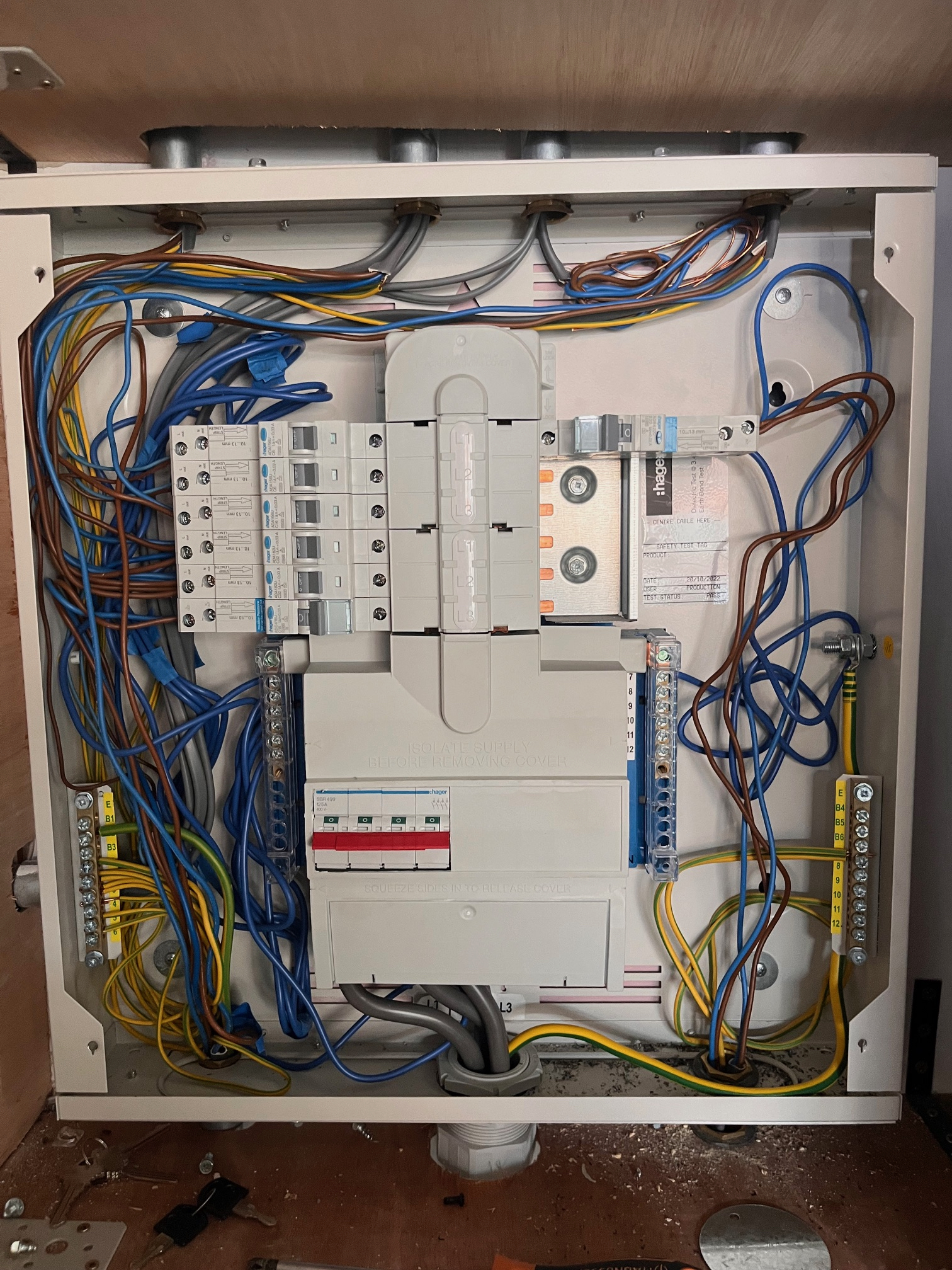

Hello,
Just wondering, can two separate earth bars in a consumer unit be interconnected with a 10mm earth cable, or is it necessary to create an entirely new earth bond? Also, what are the pros and cons of each option? Many thanks in advance.
[ElectriciansForums.net] Earth bars interconnected hager
On Hager dual row consumer units, I've found the connection between the two earth bars (via the casing) not actually that good. So I always interconnect them, and I'd probably do the same here.
They are already connected together through the steel enclosure.
But yes you can install a link between them if you want to.
Will do many thanks
