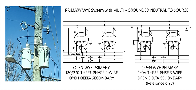

Never head that one before. I think what is being described is an open delta configuration. The primary takes two MV phases connected in open wye grounded, and the secondary is connected in delta giving 240 volts open delta, 120/240 open delta or 240 volts corner grounded open delta.
Here is an example:
Open delta made sense to us, however in the UK we wouldn't use it, we may have two transformers across two phases, but the secondaries would be treated as two different supplies.

Florida power and light most certainly had three phase transformers (3 primary windings) where two phases came from one ohl, and the third came from another ohl.

Honestly, its a bit alien to me in that I don't agree with it. But thats how its done and few question it. This paper however does though it could be written a bit better:
Regarding FP&L do you have a picture? Never seen that done before but it is possible they are doing it- a million flavors for everything exist in the US lol.
