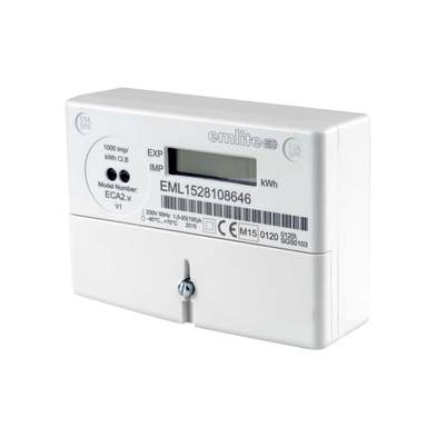

Just been reading around MID approval for these meters.. I don't think my setup will qualify as outside the scope of MID, and it certainly isn't MID-approved, so maybe I really am best abandoning this meter? Just limiting everything with a small say 6A breaker and using a low power kettle should be enough to keep usage down to a sensible level with any luck.
I don't know the regulations for electricity billing, but it might be worth checking that as you say. You can get MID approved meters quite cheaply, but not the payment-controlled sort. For example:
If the folk using it are moderately trustworthy you can probably just have a fixed fee and include power in it, but if in doubt then such a meter would at least allow you to check that the usage was "reasonable".
An occasional use kettle and some LED lights won't take much, more so if the lights are automatic where practical (e.g. movement detecting, PIR + photocell, etc). What eats power is someone bringing an electric heater, but as you say a 6A MCB might keep that away!
