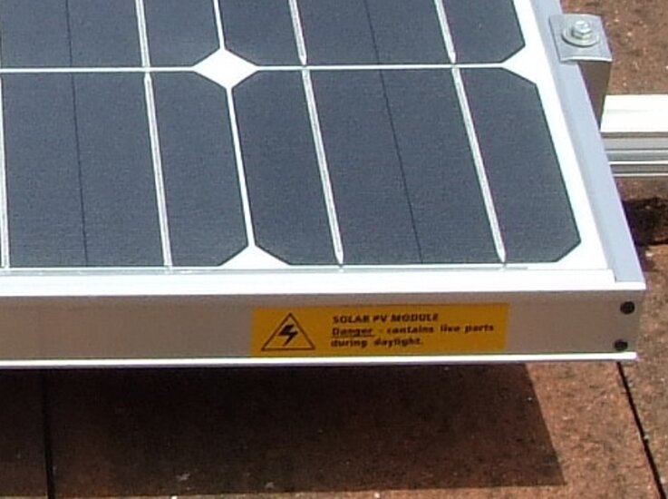

Good old Sharp's installtion manual says:
GROUNDING
All PV modules must be grounded by electrical connection of the module frames to ground. Please be careful in arranging the system ground so that the removal of one module from the circuit will not interrupt the grounding of any other modules. The modules should be grounded to the same electrical point as described below. Each PV module has a hole on the side frame for either a bolt, nut and washer grounding the module to the frame, a ground lug fastened by bolt or screw, or appropriate screw (hardware not provided). An example of acceptable ground connection using a bolt, nut and washer retaining a ground lug is shown in figure 3. In a connection of this type, the hardware (such as a toothed locked washer / star washer) must score the frame surface to make positive electrical contact with the frame. The ground wire must be considered within the requirement of local regulations at the site of installation.
Image here:
[ElectriciansForums.net] Earthing the Array - Practically
And Schletter do a special clamp that is deisgned to penetrate the surface of the frame slightly (it has a point on the underside).

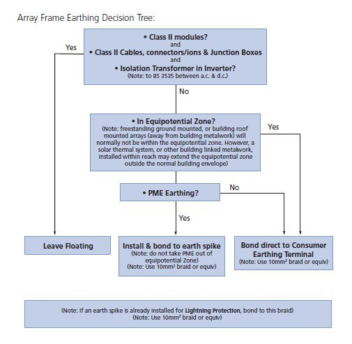

We're talking about
2.2.1 Earthing of exposed conductive parts (array frame)
as per the guide, and the assumption is this must be earthed.
We're talking about
To expound this why is the frame considered an exposed conductive part. The panels are Class II and I believe that DC cables have a double insulation, as the BS 7671-2008 gives the definition of an exposed conductor part as being
"Conductive part of equipment which can be touched and which is not normally live, but which can become live when basic insulation fails"
So would think that there is little reason to earth the frame.
The majority of installations will utilise class II modules, class II d.c. cables & connectors and be connected to the mains via an inverter with an isolation transformer. This approach is recommended and permits the array frame to be left floating.
Notes to terms used in diagram:
a) Isolating transformer: An isolating transformer is one in which the input and output windings are electrically separated by double or reinforced insulation (see BS 3535).
While the hazards presented by an array frame reaching the system d.c. potential may be significant, the potential fault/shock current is typically much less than that from a mains fault. Hence it is the electrical separation of the mains from the d.c. using an isolating transformer that is the key determining factor when assessing the requirement for array frame earthing.
b) ‘Equipotential Zone’ is defined as a zone in which exposed-conductive parts and extraneous-conductive parts are maintained at substantially the same potential by bonding, such that, under fault conditions, the differences in potential between simultaneously accessible exposed and extraneous-conductive parts will not cause electric shock. ‘Extraneous-conductive parts’ are conductive parts liable to introduce a potential, generally earth potential, and not forming part of the electrical installation, such as a water pipe, outside tap, a metal downpipe – anything conductive that is connected to ‘Earth’ but not electrically part of the system.
c) PME – Protective Multiple Earthing – an earthing arrangement whereby the supply neutral and earth are combined into a single conductor. Where the incoming supply is PME (the majority of domestic supply arrangements), the PME earth cannot be taken outside the equipotential zone. This is to prevent the potential shock hazard should the supply neutral ever be lost.

Sorry Worcester not sure where this is coming from but is this a serious suggestion, and where does it come from as neither the BS 7671-2008 or the ESQCR-2002 prohibit the exportation of the earth on a PME system.
Why is the PV industry trying to re-write electrical regulations.
MS, Yes I agree it is rubbish albeit that is not what Worcester is trying to discuss here.
