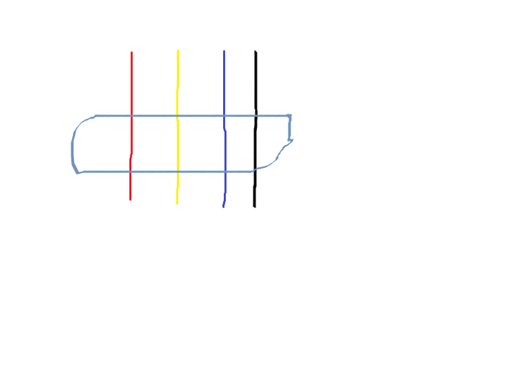

I vaguely remember an illustration in one of my books showing 3 phases of a supply entering metal trunking seperately, and the words ' THIS ARRANGEMENT IS NOT PERMITTED' emblazoned beneath it.
However I have been going through all my books and cannot find it.....
Anyone know what I'm on about?
Yes.very good.:yesnod:
Let me re-phrase myself...
Does anyone one know of a reference in published literature (E.G. the Regs.:book:) because I think I have come across this situation at work, and don't want to go in half-cocked.
Thank you:smiley2:

Yes that is correct
Three phase or single phase it is not correct.
