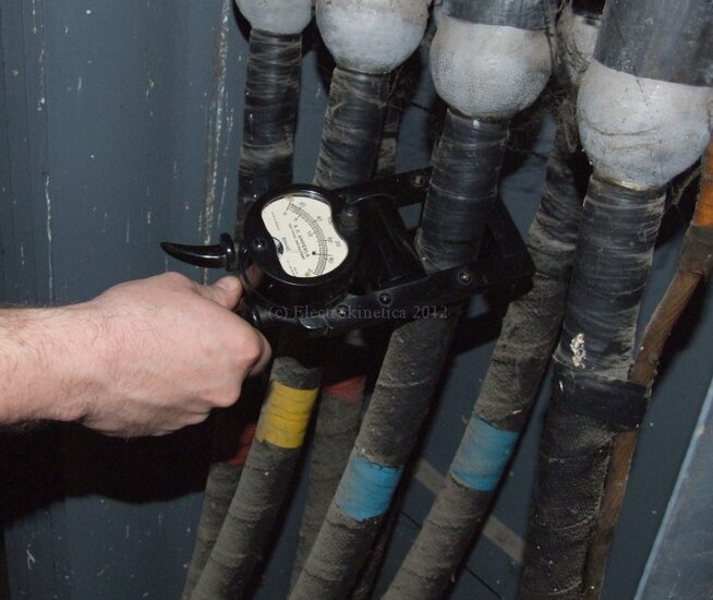

Here's one I did earlier, no alchohol used.
[ElectriciansForums.net] Eddy Currents
Forgive my ignorance, but why seven holes ( assuming a three phase supply)?
For hight current it is better to use two smaller conductors per phase (look up skin effect). The neutral normally only needs one conductor.
Modern practice due to harmonics is to use two.
Where high unbalanced harmonic loads are expected. The transformer will be rated type "K" and three neutral conductors provided.
