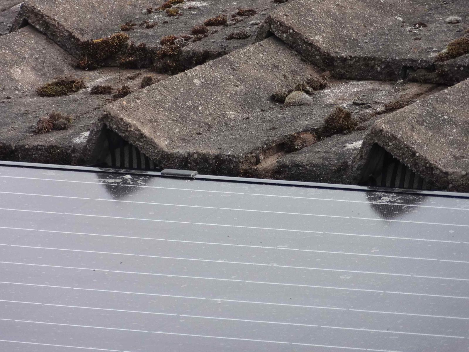

6kWp west facing roof integrated system.
[ElectriciansForums.net] EF members' installs - show us your work![ElectriciansForums.net] EF members' installs - show us your work![ElectriciansForums.net] EF members' installs - show us your work!
This used GSE integration on a monopitch roof. Little details a good roofer helps with is things like bird guard in tile openings. This style of tile is notorious for nests if not blocked. The last picture was taken before the roofers had got the Windowlene out.
I was surprised the customer went for it. The array experiences 11% shading loss, has a low pitch at 18 deg, and faces west. Add all this together, and output is predicted at 4120kW/a. Uses an Eltek 4.4HE-T limited to G83/2 on commissioning.
Roof integration added to installation cost. However, from the customers viewpoint it still gave a better return on their money than leaving it in the bank.
