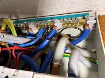

1 1.3 Consumer meter tails exposed single insulated inner cores. C2 Meter [March 2021 none highlighted]

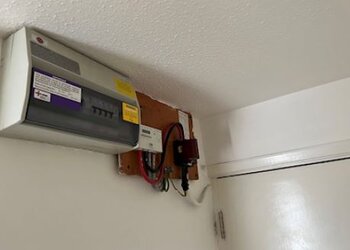

3 4.1 Consumer unit mounted at a height which prevents ease of access for user. C3 Entrance [March 2021 No observation see pic under next point[]

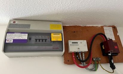

4 4.5 IP rating of consumer unit not to BS 7671:2018+A2:2022. Back and top of Consumer unit has an unused opening exceeding IP2X. C2 Consumer unit [March 2021 reading marked as pass. New Consumer Board was installed 2012/13 when we upgraded the kitchen]

5 4.6 Consumer unit in a domestic household premises is not metal, located in the sole means of escape for a dwelling area. C2 Entrance [March 2021 no issue highlighted]

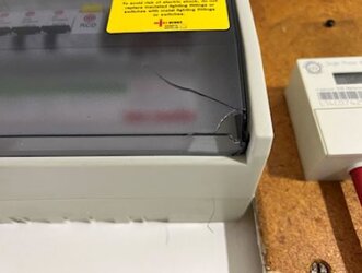

6 4.7 Consumer unit has a crack in the protective device access flap. C2 Consumer unit [March 2021 this was a C3]

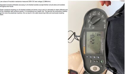

8 6.3 Low values of insulation resistance measured 250V DC test voltage (2.28M/ohm). Degraded di-isoctyl phthalate occurying in all checked sockets (except kitchen circuit) wires and sockets throughout the house. C2 Several locations [March 2021 reading >200MOHM]

Probably the biggest expense would be rewiring the sockets. Yet the insulation resistance of 2.28M is above the minimum, and so perhaps not strictly necessary at this time. If it is oozing out of any socket faceplates (it sometimes is), they can be replaced in the meantime.

1. C2 £45 to terminate so no basic insulation showing.
4. C2 £45 to cover holes.
5. I would put this as a C3
6. C2. Replacement cover (If possible) £70
8. IR results are above 2, so I wouldn't be coding.
It's the green goo that could be the costly part. I would C2 it if there was severe green goo which was either damaging accessories or degrading the cable. Even though 2.28Mohms is acceptable, mixed with green goo it may indicate a breakdown of the insulation of the cables meaning you may need a rewire. I would get two further electricians in to get 2 more quotes.

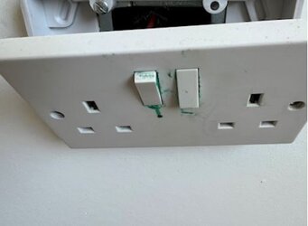

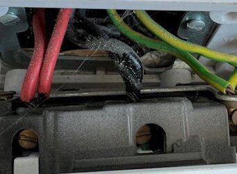

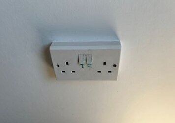

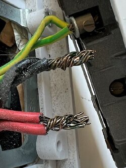

Only two sockets are showing green goo outside and of which only one was looking like coming out from the switch after the inspection was completed. Picture of the main culprit socket below:
That is not a good sign.
As above, you might argue over some of the codes but there is no doubt that cable is well beyond its working life. Also it is worth pointing out that this problem with the type of PVC plasticiser causing the degradation of insulation and "green goo" was limited to a period of a few years in the late 60s/early 70s so that wiring is 50+ years old now.

The meter tails is a 5 minute fix for an electrician , literally just need re-terminating
The hole in the top of the consumer unit is pressed up fairly tight to the ceiling so no real risk of someone shoving their fingers in. You can easily just fill with hole some white mastic bathroom sealant . Likewise the cracked cover isn't really be a C2 as its just the flappy cover, I come across many many consumer units where the plastic flappy cover has been snapped off altogether. I just recommend they find a new cover on Ebay.
Low IR is FI not a C2
Geen Goo is a problem but sometimes the offending cable can be cleaned with a wet wipe and the face plate changed then it becomes a more detailed FI where you want to inspect all the cables and a possible partial re-wire req latter on

The wiring for the sockets is now seriously old - and when I see that the two things that matter are the IR reading and presence of green goo. It tends to be 1960's wiring that exhibits this. As said above once you see green goo then it's generally game over the the related wiring. I'd agree that a partial rewire is now required, I'm afraid.
Respectfully disagree there Dusty. I used to think that too but I've been told by a few old-hands that FI is for where we can't establish a result, not for where we don't know why we are getting a result.

The meter tails are at the meter. Can only be worked on by meter operator engineer, as it means pulling the fuse/ cutting the seal
The holes in the consumer unit are up against the ceiling… jam a bit of plastic inbetween to cover.😄
Should get a replacement cover off eBay… at least it’s still got a cover!
The green goo is the biggest issue, but the low readings may be linked to that. If the stained sockets were changed, the reading might rise… but the goo would likely start oozing into the new ones…..

I come across Green-goo a lot at the housing estates near me , I do my best to clean the offending goo off and sometimes replace a little bit of cable where possible and a new face plate. I have been back to some of these jobs 12-18 months latter and it seems to have done the trick.
That doesn't look great Josh.
As the others have said it's looking like a rewire.
You have quite bad green goo, IR results close to a failure mark and damaged accessories. As @pc1966 said that cable is 50+ years old. It's probably time for a rewire I'm afraid. It might be worth thinking about getting some of the other circuits rewired at the same time if they are of a similar age, or at least discuss it with the electrician.
As for the first EICR you had done. It seems possible/likely that they did not do a terribly good job.
