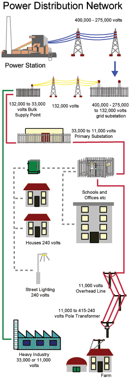

Hi guys, I've got my re sit coming up for my electrical installation technology exam and quite a few questions came up about transmission of energy and different sizes of voltages that are used to supply various different applications, if you could leave answers of the different size voltages that are used for what I would be grateful, cheers
I think you are attempting to determine something like the attached image.
[ElectriciansForums.net] Electrical Installation Technology Exam
Obviously the voltages have magically changed to 230V and 400V in the European state of the UK.
