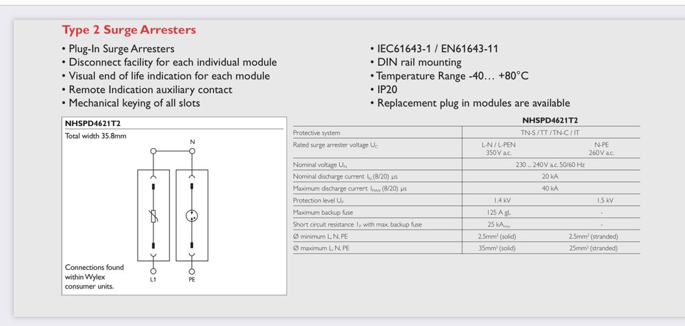

Hi - as far as I know this SPM is suitable for most earthing systems, I don’t know why that doc doesn’t show it. Here’s a screen shot from another site of perhaps a later spec sheet and it’s got them all listed.
[ElectriciansForums.net] Equipment understairs.
That makes more sense - also seems to suggest that 125A main fuse is an acceptable backup, although other manufacturers seem to have gone to requiring it's own MCB of 32A.
