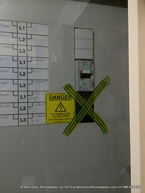

We visited one of our sites today, it had also not been generating for 5 days.
We thought it was a comms error to sunny portal at first as we've had a few issues with that site, however as I couldn;t log in to it remotelyu at all, we decided as site visit was nescessary:
We found the problem :)
Someone had nicked the breaker !!!!
