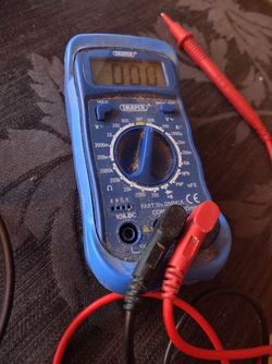

I've measured voltage at the light switch and strangely I had different measurements, but the wrong way round for the light that is showing the flickering. Just to recap I have a 4 gang switch, and I'm taking power from the two switches which I know work - the outdoor lights and security lights. The power I was using for the hall lights was coming from the 2nd switch, and was going to L2. The measurements I had for the 1st switch was a wandering 199 - 220, the measurement from the 2nd was a steady 197. You would suspect that the wandering voltage of the 1st switch would be the one causing the flickering, but I was connected to the 2nd switch, which makes me think that the current is too low at 197?
these all seem low, what are you measuring between?
I'm using the terminals on the back of the switch and placing the red/black prongs on the screws holding the wires on COM and L2 terminals
This image shows the device I'm using for measuring the voltage at the switch

That will not give you the voltage at the switch, it gives you the voltage across the switch.
word wise, it seems like a subtle difference but it makes a difference.
with the method you are using, you should measure 0v across the switch when the light is on.
the voltage measured with the light off is not relevant.
to measure the voltage available at the switch you need to be measuring from a live to a N or earth.
Note: the quality of workmanship on that switch and connections leaves a lot of room for improvement.
bare cpc wires (earth) should be sleeved with a minimum amount of copper showing, they should all be connected together not joined where it seems convenient.
